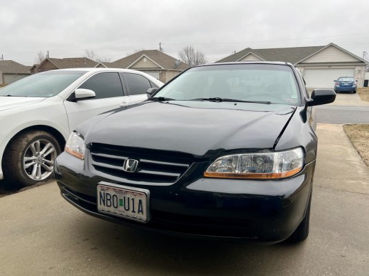

Where do I start with the headlights? When I test drove this car, the windshield had(and still has) a wave in it, the AC didn’t work and the guy selling it was flipping it and he performed body work. ALL red flags and I should’ve known better. Didn’t get a carfax and I still haven’t.
Pretty positive it’s got a front end collision on it. Main bash bar is straight with just a *TOUCH* of damage/rust on the last like 2 inches of the driver side. Rad support looks straightened and hood latch latches but it sits at an off angle. Also, the left headlight doesn’t sit flush with the left fender. My guess is someone came up on a larger vehicle too fast and swerve to the right, hitting said large vehicle with the front left side of the car. Sold it the guy I bought from and he replaced the bumper and headlights and probably threw in the cheapest, used windshield he could find.
Oh, and the power steering pump was, and still is, whining. More so then than now…
Anyway, removed old left headlight and found the far left bottom bracket had been broken off. Attempted to to install the new headlight and alignment was WAY off. Barely got the top bolt in. Side mounting bolt was decent and the underside holes don’t line up at all. It got dark and cold so I just rolled it into the garage to mess with tomorrow. Should be able to manipulate it enough to get the one hole that holds both the light and bumper bracket to the car. Hoping the right side light goes smoother.

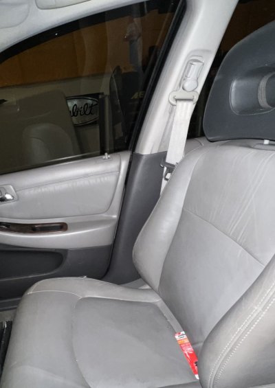

Passenger seat base moves forward and back but the switch for the seat back is broken and you can lean the seat forward or backward at all. Also the SRS light on most likely due to dirty buckle connections and/or the recall needs done. My local Honda won’t do them so I have to take it to the next dealer, an hour away.

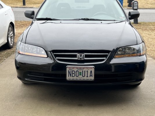

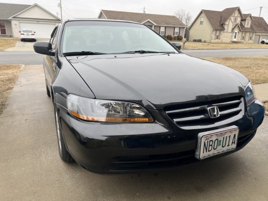

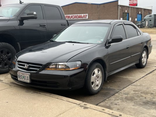

Got the lights swapped out. Holy buckets. Car has definitely been wrecked. Driver side light was an absolute nightmare to get in. Not sure how I did but I did. Right side wasn’t as bad but still needed a little coercing. Let’s see if I can get pics up…
A little hard to tell but noticeable if you know what you’re looking at.
That’s it for now. Still have to drive it at night and see how the lighting angles are and make adjustments.

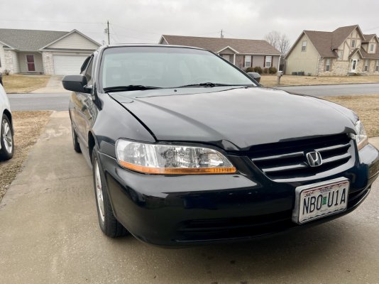

Right headlight looks to be aimed okay but the left one is too high. Hoping they have more adjustability than the previous set and I don’t have to live with blinding people all the time.

Also found a set of grey coupe headrests but there’s a problem…
They’re not the same color as the seat. Also not sure how I feel about it. Luckily they do match some of the other interior trim as far as color goes but I feel like I’d feel a little better if they matched entirely. Maybe I’ll find some grey coupe seats and swap them in, lol.

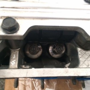

No word from the co-worker. Regardless, pretty positive my leak is the VTEC solenoid. I have all 3 gaskets to do it, the filter housing, and the sensor. Gotta procure a filter and oil. Getting OEM filter from Honda and going with Mobil 1 High Mileage 5w30. We carry 5w30 at work but it’s not “high mileage” and even after my discount it’d be about the same price.
Only thing(s) I’m kinda worried about are toque specs on the housing bolts. I’ve read 16-18(20?) ft/lbs but everything I’ve seen and read says ratchet tight (or small extension tight) should be sufficient.
And I’ll need a 22mm socket/wrench for the sensor and I’m not sure I have one, lol.
