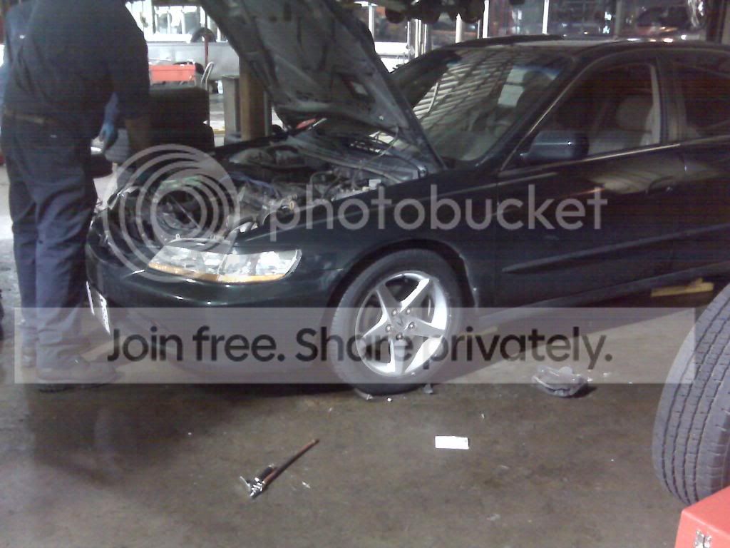

got most of my 5 lug conversion done. just have to install the parking brake cables, get a front camber kit & find some lug nuts that dont stick out as much, lol.
sorry about the crappy pics, but they are from my cell.

thanks Alejandro. i finally got the right lug nuts. man, it makes a world of difference, lol.

finally got the acura lug nuts, so they dont stick out. once i clean the car, i have to get some better pics.

well, i went to a junkyard. got the rear spindles (complete), for about $100 for the pair. each front spindle ran me $75. im the service manager at a shop, so i got the brake cables from the dealer, front & rear rotors, front calipers w/ pads from my shop, so those prices vary. i did the rear spindles including the brake cables. while one of my techs did the front for me. after i got everything together, i found that the bearings were bad, so i ended up replacing both rear bearings too.
