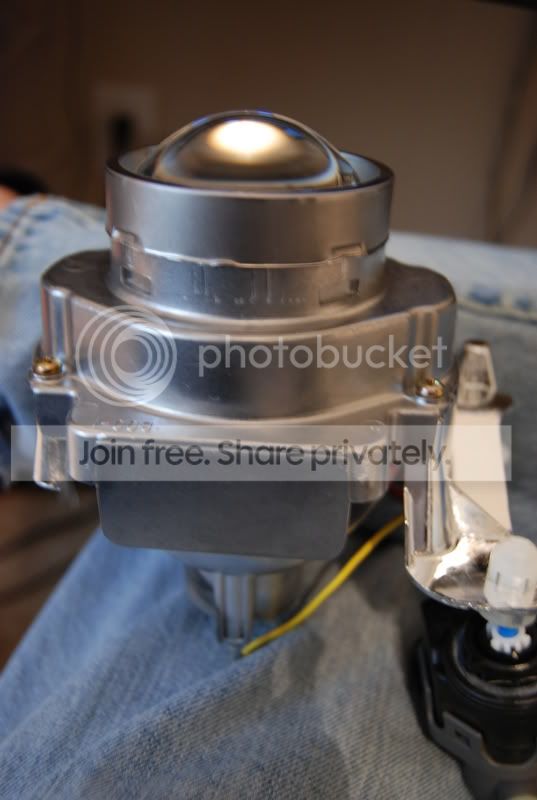

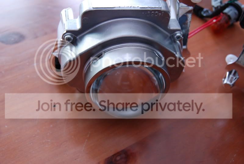

Here here the stock FX projector right when i got it

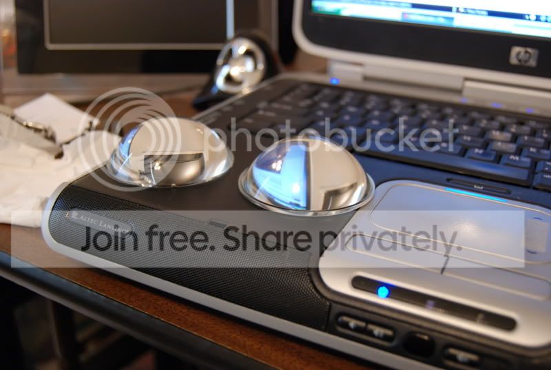

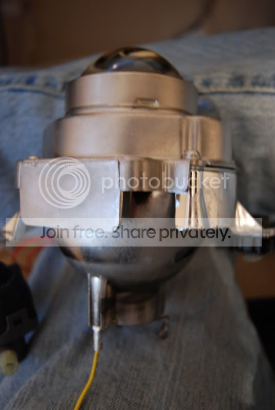

The left lense is the 300 and the right is the FX..you can tell the difference because the FX has that lip at the bottom..
To get the lense holder off you take a small flathead and pry it into the small wedges around the bowl...
You slowly move it up and try not to bend the lense holder because this will make it harder to put back on

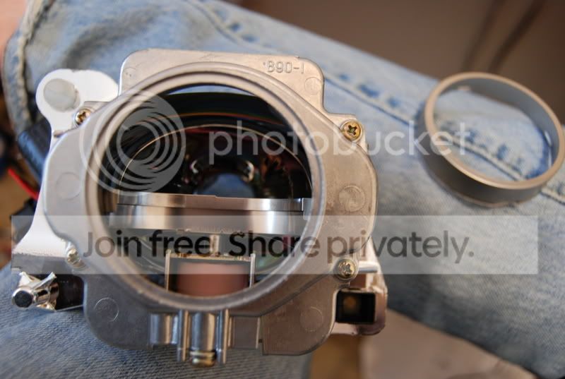

Once it is off this is what it should look like with no lense. We added a small spacer to that lip around the edge and set the 300zx lenses on top of that..This mod is what gave the projectors all the color

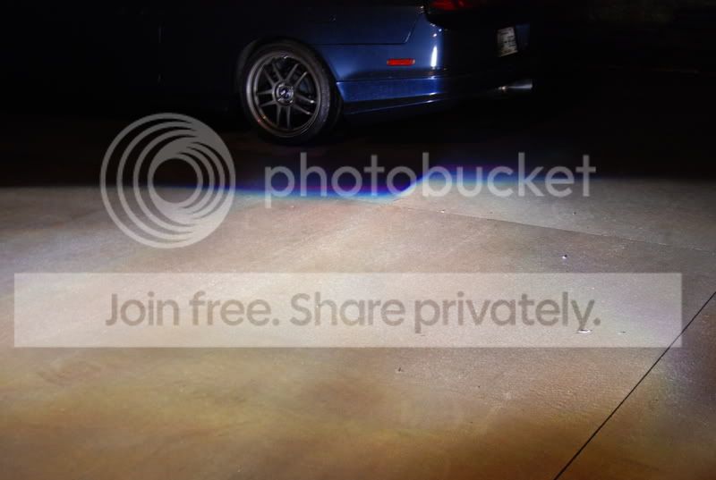

Then this is a picture of the projectors modded, bad picture because we didnt' have a good wall to shine it on..this is just from 4 feet away pointed down..hence the large mountain

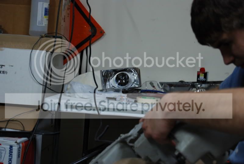

Anyways after all the projectors were swapped we started with the fun part. Cutting up my perfect OEM headlights...This is very messy so do it in the garage and make sure to wear glasses and a mask..I didn't take any pictures because it was too dusty in the garage

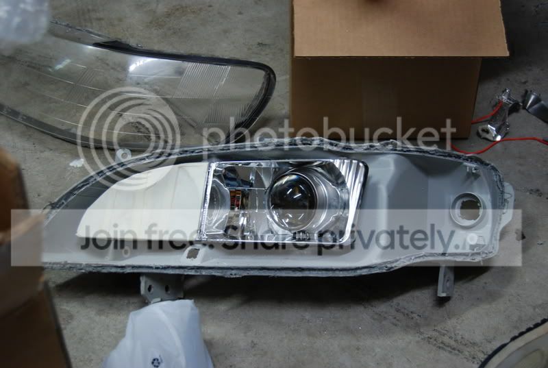

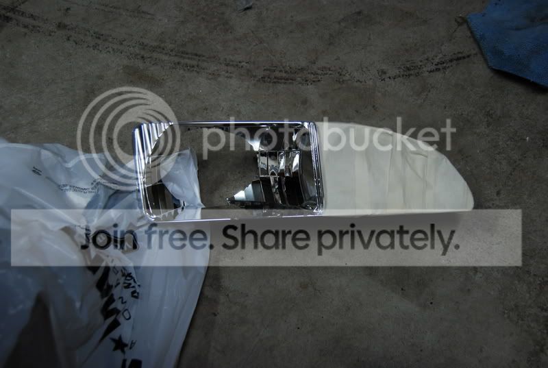

Here is the low/high beam reflector after being cut for the projectors
Projectors fit perfectly, to get them to stay just add some JB weld or you could screw it in i would assume..
Once you get the reflectors cut it is now time to cut the back of the headlight housing..this isn't dusty but the plastic will get hot so watch out..
Here are the projectors sitting in with the back cut and everything in..

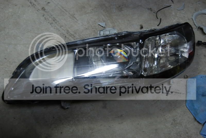

Was messing around and we had a blackhousing sitting around so thought i would see what it woudl look like...this is pretty much the final except will have shroud and orange amber strips
Just have to wait for shrouds to get here, and i will finish this DIY up
