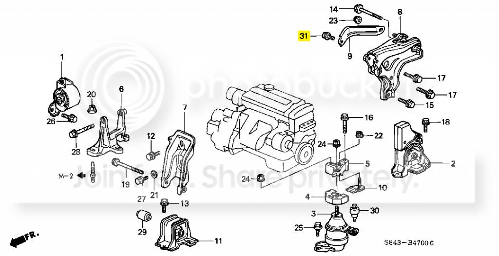

alrighty guys so i still have a pretty bad clunk, im HOPING that its coming from the rear mount.
stuff i got ready
- Intake Manifold Gasket Set
- Valve Cover Gasket Set
- Rear Engine Mount
- Clutch Master Cylinder
- Slave Master Cylinder
- Carb Cleaner
hopefully the rear mount being replaced will stop the knocking, if not ill be replacing the clutch, all of the control arms, and all of the ball joints.
BUT id like you guys to take a look at the picture, im missing #31, highlighted, would this cause excessive knocking in the mount? id say no but you never know.
so after this weekend when i replace all of this, ill report back, and let you guys know whats going on.

that bolt you are missing shouldnt cause EXCESSIVE knocking in the mount it seems to be pretty secure with the other several bolts..replace it and the sound should be easier to isolate you should be able to get it from a JY its only a bolt
and man you said "change the clutch" like its a walk in the park lol also check radius arm bushings mines was shot and caused a huge knock in the front of my coupe thought it was the mount..but it wasnt
radius arms bolted to the top of the control arm here's a diagram of the bushings

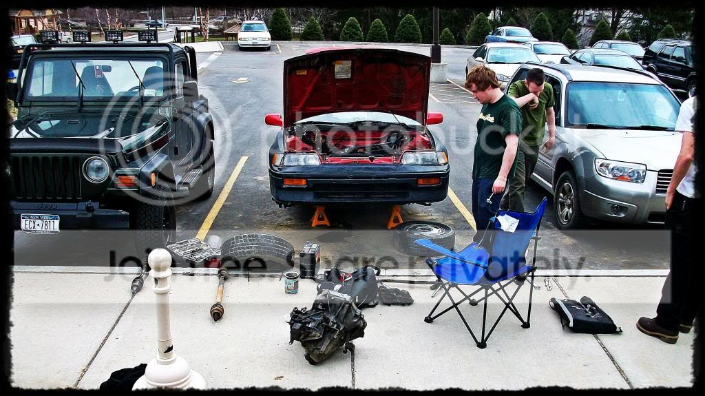

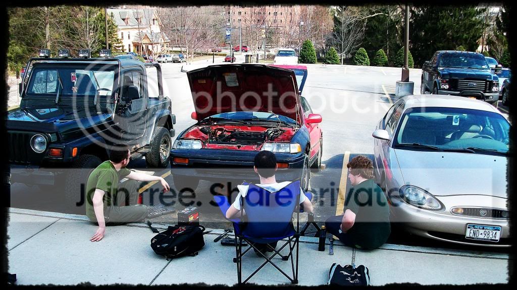

only thing i DONT have is an impact or a lift. but a breakers bar and a few days of post PBBlaster spray helps alot.
id say the actual hardest thing to do would be to break ball joints, in my opinion.
just for fun i did manage to find the pictures some girl took while i started to remove my trans at college, there was a challenge; "remove this transmission within an hour" it ended up being right around 45 minutes. i ended up doing a full rebuild with new syncros and bearing, the shift forks broke on this trans.
they helped and we all got a beer!!!!
back to the accord, parts on the way. well see how it all goes
