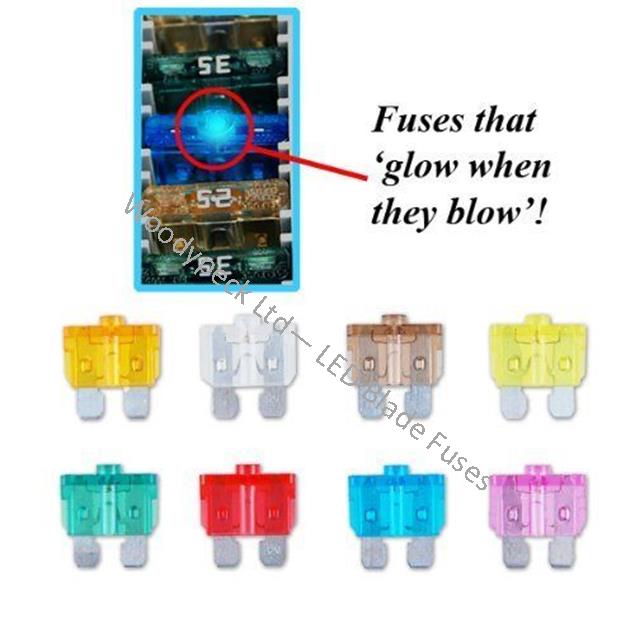

put in new fuse, one of the ones that lights when it's dead.
dis connect all.
still on?
move & plug harness till it blows, now you know where
xci.ed6
Sep 5, 2007
2,909
9
Tampa Bay
disconnect junk
put in fuse, light should be off!
move, plug, check, move, plug, check, etc...
light will turn ON when you find the problem (the light will turn ON when fuse is OFF, this may be the confusing part)
(also done w/ test light/dvom/etc..., this is the 'easy' way)
