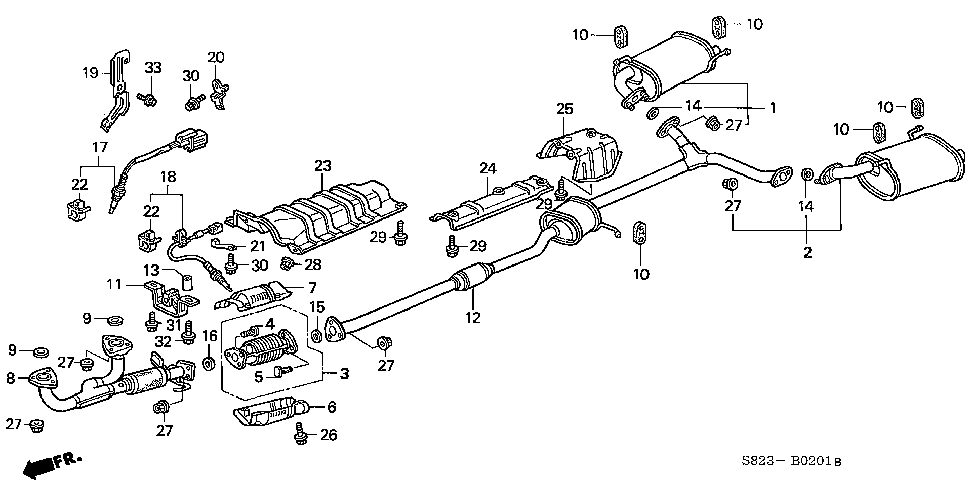

Exactly ... Just a couple more things you should watch out for.
1) Try to get one with a port for a midbody 02 sensor, otherwise, one will have to be made for you, no 02 sensor, and you're asking for check engine lights (#18 in diagram below)
2) Shouldn't be wider than 5 1/8", otherwise you're gonna have to do some cutting of the heat shield and other components (#7 in diagram below)
