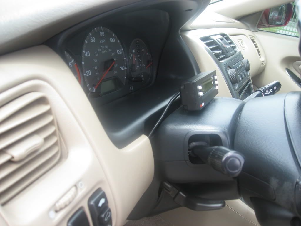

Hey Guys i recently purchased a ScangaugeII here are my thoughts on it. So far i love its a great lil product. It brings the Scangauge,a 6ft cable to hook up to the ob2 computer and 2 velcro sticky tape. I bought two cables since the one in my accord is gonna be permanent. Installation was a breeze its basically plug and play. I didn't have to take anything apart in the car i just used some electrical tape to hide the wires under the dash. To set up is also very easy just put in your engine size and engine type diesel/gas/hybrid/ and units of measurement liters or gallons the ScangaugeII does the rest. Also gives u the option of calibrating it if your Speedometer is off due to larger wheels or something. Lets you calibrate your tank too if you did over or less miles then what it stated you can put a +/- % value. Some features..

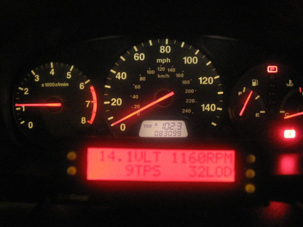

You can use 4 different type of gauges while you drive here's a list of them...
» Fuel Economy
» Fuel Rate
» Battery Voltage
» Coolant Temperature
» Intake Air Temperature
» Engine Speed (RPM)
» Vehicle speed (MPH and KM/H)
» Manifold Pressure
(not available on some vehicles)
» Engine Load
» Throttle Position
» Ignition Timing
» Open/Closed Loop

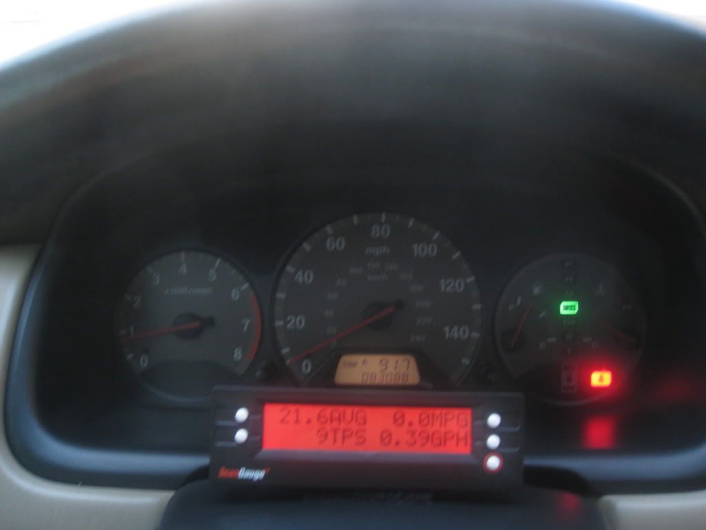

Thats copied off the site make my review a little easier and more detailed. Ive managed to get my mpg from 21 average to 27 my last tank so it does help with your driving habits Ive also noticed i get better mpg going 42 opposed to 38 just small details that can help you save gas. The scan tool is also a feature that pays for itself. I manged to clear my dads check engine light in his car and pull the code up. It wont tell you what the code means but you can just Google it. Keep in mind your check engine light will return if the problem isn't fixed. Has 7 Colors and a custom setting that can give you 63. So does anyone out there in 6th gen land have this lil gizmo ? if so chime in. If anyone's interested i can do a DIY

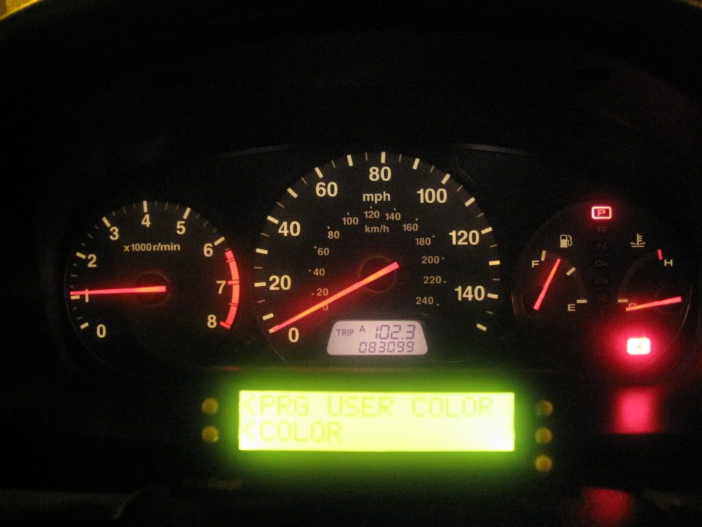

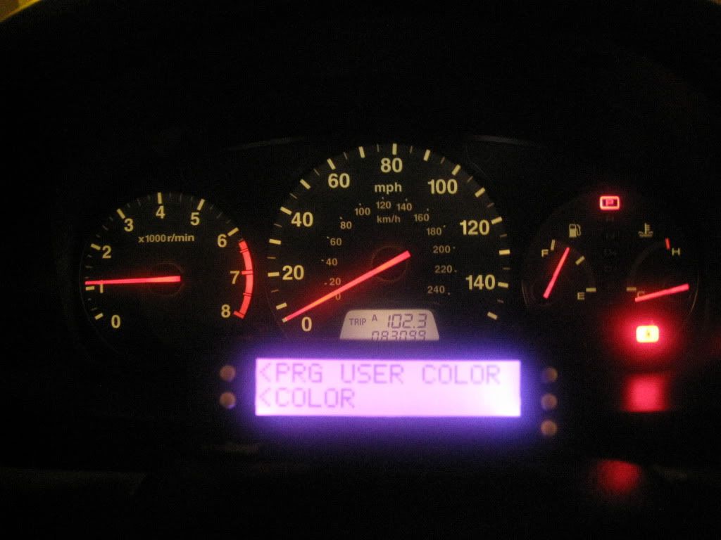

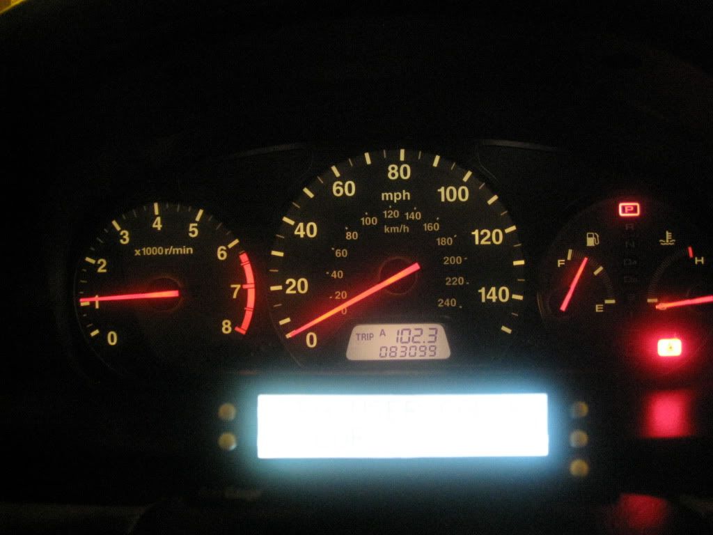

159 on amazon. No other power sources just the ob2 connection. the cable has a ob2 connection and the scangaugeII has a Ethernet input. I leave it plugged in but u can easily remove it and use it to scan another car or try it out on the wife's car etc. They also have other gauges you can add like hp and a transmission temperature gauge but i dont think the transmission temperature works in our cars since the car itself needs to have these sensors already installed =( unless im mistaken. Ill take some night pics of it with the color variations
