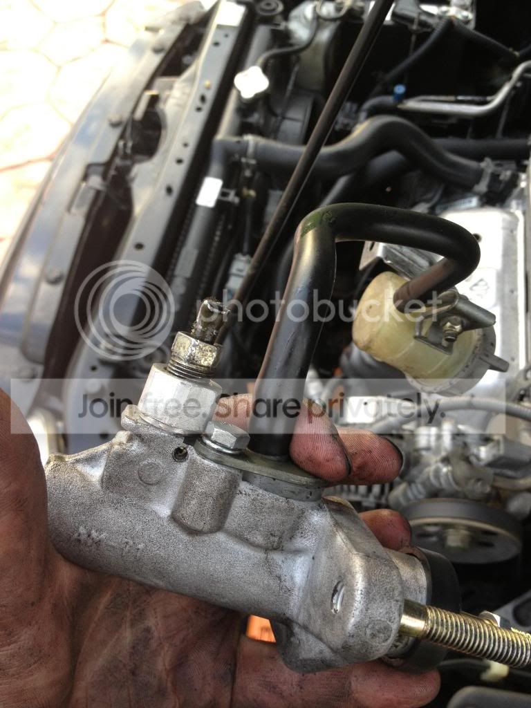

I recently purchased a 2002 Accord Coupe EX 5speed. I bought the car knowing the master cylinder needed to be replaced. So today I attempted to replace the Clutch Master Cylinder. As anticipated, I ran into major issues with the amount of space between the firewall and shock tower. After 4 hours of trying to complete the job, I managed to break the clutch hard line off the MC. -_-

I manged to break the clutch hard line from trying to "coax" the MC into the small area allotted. Originally, I put the MC in the firewall with the reservoir attached only. But I could not attach the Clutch hardline with the cotter pin to the MC mounted in the firewall. It was damn near impossible.
Any tips on this? Hopefully I can get the accord running by tomorrow.
Many Thanks in advance!
Picture of New MC with broken Clutch line fitting:

I've tried a couple different things...
1 - Install hardline and route it around the motor, "attempt" to shove the MC in between the shock tower and firewall with it all connected. It's difficult, you'll scrape the crap out of your knuckles, etc.
2 - Route the new hardline but don't connect it to MC. Install new MC and resevoir. Push hardline into MC. Holding that pin carefully, use a screwdriver or long pry bar for leverage to push that pin in once you have it lined up.
There is no easy way to do it b/c of the minimal clearance. Make sure you bench bleed the new MC first.

Thank you for the advice. I attempted both ways you described today. Im going to give route 2 more of a shot though. Maybe theres a pressure plier that is thin and long enough that can hold the pin and secure it.

I used both hands squeezed in there. One holding the pin to help line it up, the other holding a pry bar as leverage to push it in. After about 2hrs I finally lucked out and it went in.

i wish i would've been so lucky lol. My hands are all cut up from all my attempts.
