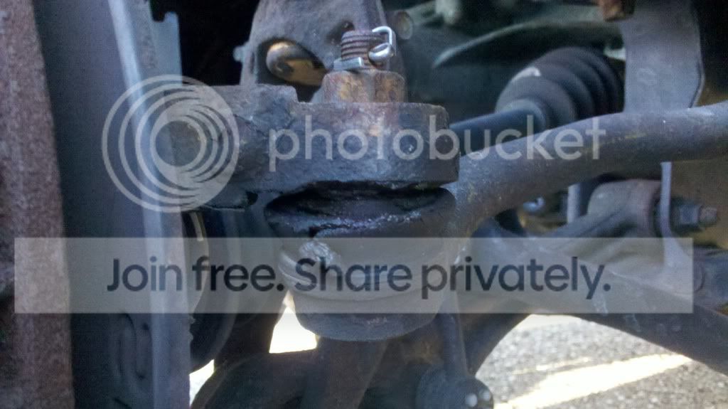

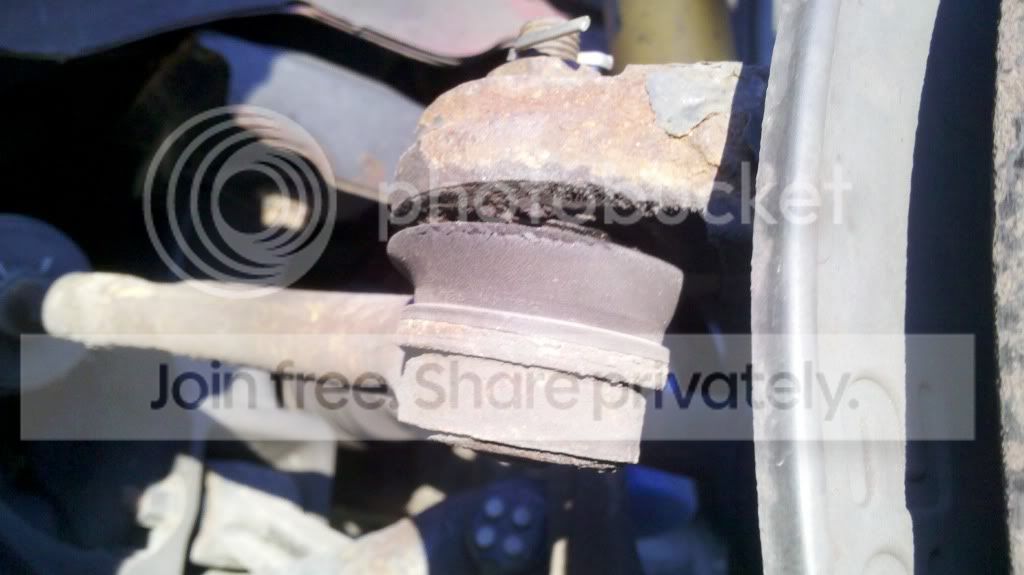

Finally got around to poking around the suspension on the front. Everything looks be in order, except for this bushing. Could this be the problem? I can rotate the bar easily with my hand. And can just the bushing be replaced, or the whole assembly?
Driver side:
Passenger side (not quite as bad):
I also noticed the very inside of the front driver side tire was worn much more than anywhere else. The tread looked normal, just the inner most treadline closest to the sidewall seemed to be more heavily worn. Same on the passenger side, but not as bad.

yeah those need to be replaced. you'll have to replace that whole arm. its really easy to do yourself. just make sure you mark the point where that arm is screwed to. you'll have to get an alignment afterwards..

Thats your tie-rod, also what can affect your toe(in/out). So if the ball-joint on there is loose then it could justify the woobly feeling, and the irregular wear. I would say replace them both as they're not that expensive and you'll need to get an alignment after anyz.
Better then doing one, getting an alignment only to do the other one later on and get an alignment again.
