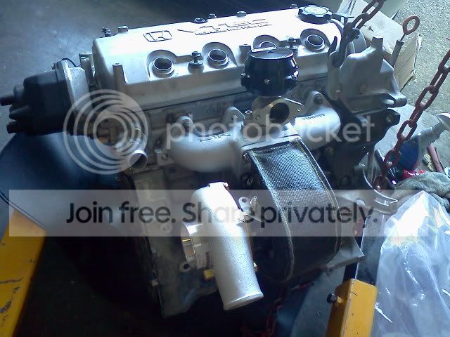

Got my new F23 from the junk yard the other day with 97k on it(my motor had 130k and was burning oil). The ARP headstuds and timing belt and water pump went in yesterday and the new motor is installed but still naturally aspirated. I have to do my emissions test before I can put all the turbo stuff on but I have everything now.

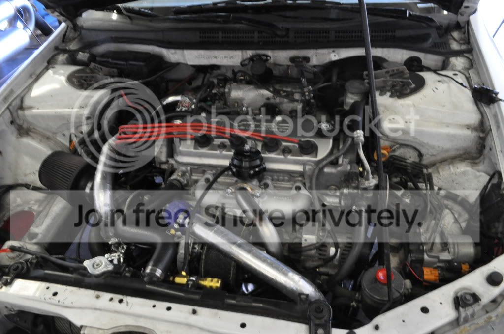

Mock up on the new motor(cell phone pic)

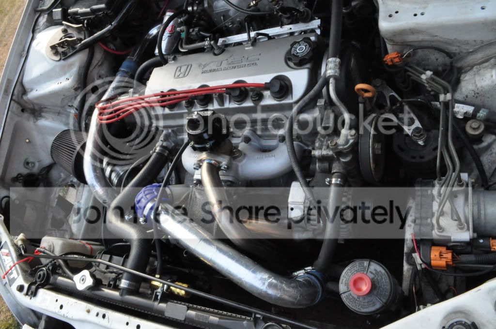

Car is done! 8/28/11[/COLOR]

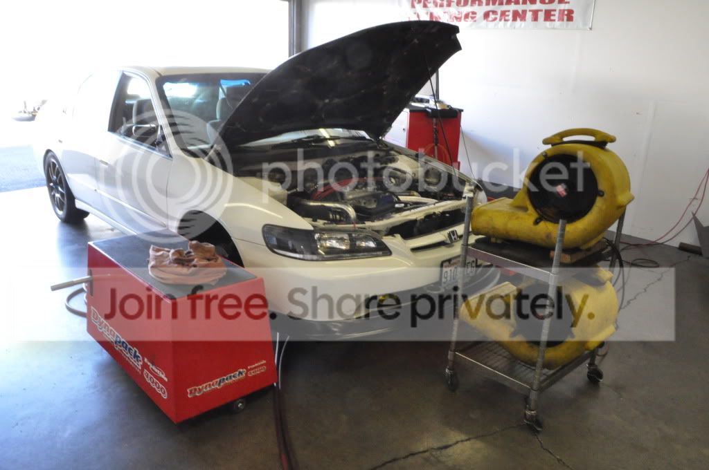

On the Dyno at Speed Factory being tuned.

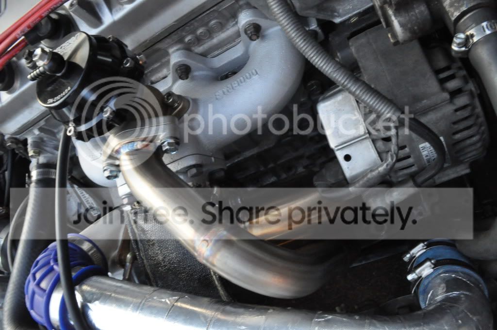

Shot of the down pipe and wastegate dump tube

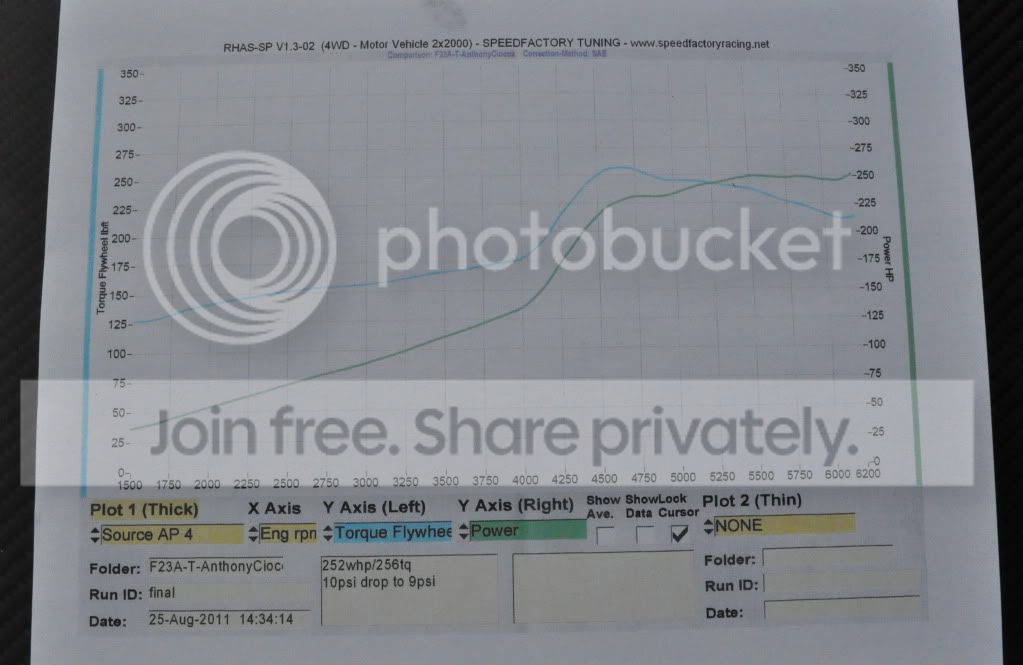

Put down 252 whp and 256 lb-ft of torque at 9 PSI!
Overall impressions: This thing is a beast now! Compared to the puny GT2560R that I used to have this turbo pulls so much harder. I will say that I'm not too happy about the turbo lag though. If you look at my Dyno graph you can see it doesn't build full boost until very late.
