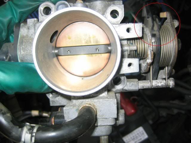

-Put a rag under the TB and turn it enough so that you can see inner side of the TB (as seen in the pic I attached in my OP). Spray the cleaner in the TB, wipe out the crud with a rag, repeat several times. That was enough to get it pretty clean.

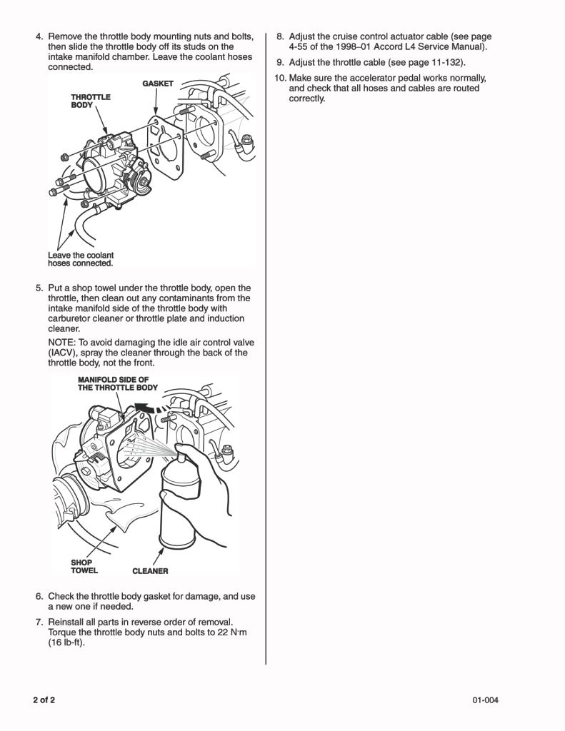

-I see where a lot of people just remove the intake duct and spray the outer side of the TB. From a Honda TSB - "To avoid damaging the idle air control valve (IACV), spray the cleaner through the back of the TB, not the front." Up to you obviously if you want to ignore that...
-Put on the new gasket and then reinstall all parts in reverse order of removal. Honda lists the torque at 16 lb-ft.

ty torny and cajun. k i got every part except how to take off those cables... can some1 take a pic how to do that please?
xi0utlawstarix
Aug 20, 2006
1,856
4o1
oh lemmie.....
to remove the cables, just "rotate the throttle shaft bellcrank until the cable is lined up with the slot in the bellcranks, then detach the cable from the bellcrank." Then remove the 2 screws holding the cable bracket to the TB. i didnt have to touch the adjusting nut or locknut.
bellcrank in red circle
