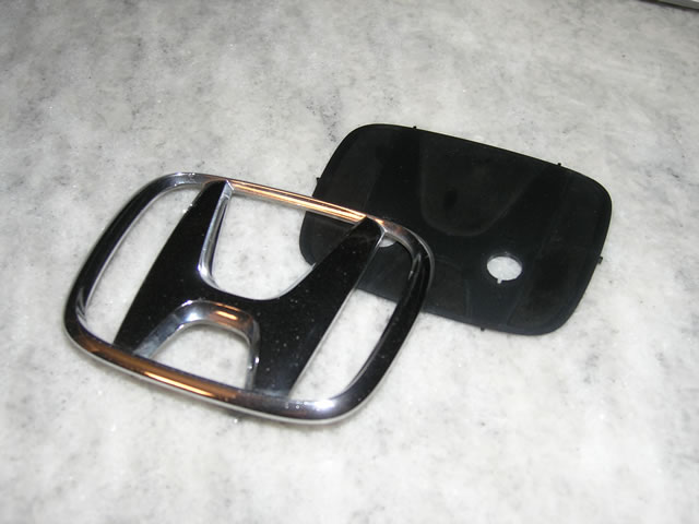

I was originally going to simply spray tint my emblems. After prepping the original front "H" that was on my car, I noticed the black plastic back was rather nasty. I know it won't stay nice but I wasn't going to put all this work into painting only to back it up with this:

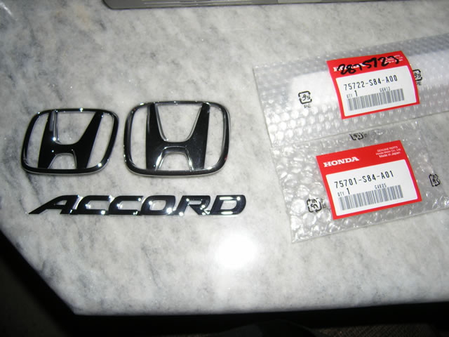

Before:

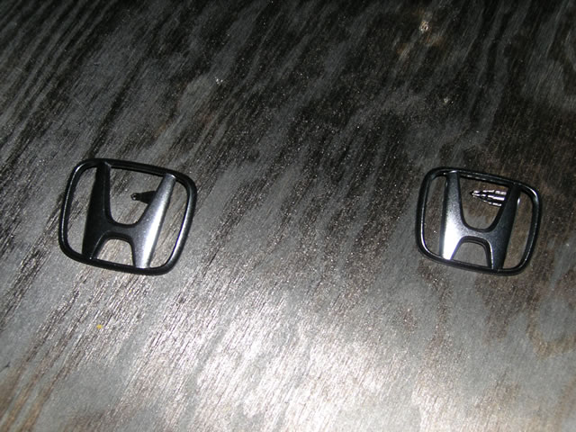

Front and rear emblems after tint (before clear coat):

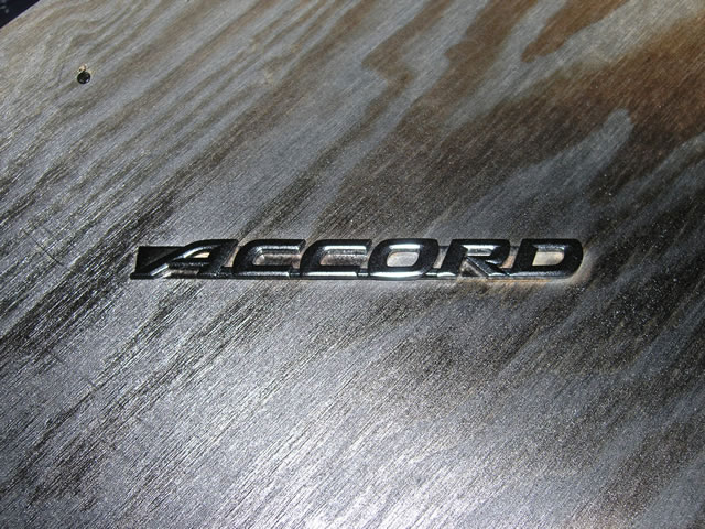

Rear "ACCORD" emblem after tint (before clear coat):

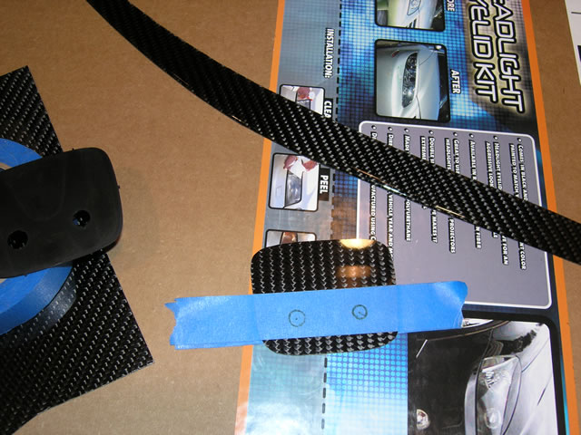

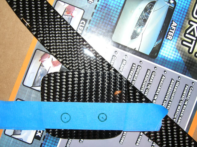

This is a picture of the first carbon fiber piece I tried cutting:
The first one ended up askew and I messed up the holes when drilling them. Thankfully, the carbon fiber is easily cut with ordinary scissors. I didn't have quite the right size drill bit so on the second one I used a smaller bit, taped the plastic back (on top of blue masking tape roll on the left) to the carbon fiber piece, drilled starter holes, and enlarged the holes with an Xacto knife.
If I were to do this again, I would be sure to cover the entire front face of the carbon fiber with masking tape to avoid scuff marks. The marks were luckly not large enough to be noticable after applying the clear coat.

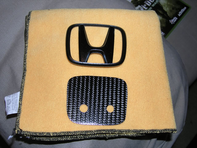

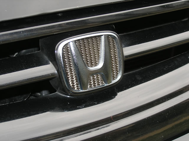

After the tint I wanted was reached, I applied clear coat to both the "H" and the carbon fiber piece.
Front "H" and carbon fiber after clear coat and light polish:
Assembled:
...and installed:
Overall, I'm really happy with the results!...:)...now for spring to roll around so I can install the eyelids.

Sorry about that. I forgot the first step (for a 2001, at least; my "grille" is built into the front bumper). In order to remove the emblem, I needed to remove the bumper.
Once the emblem has been removed, the silver "H" can be separated from the background as shown in the first picture. It just takes a while to get started; there is no glue but it's a snug fit.
