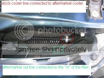

This view shows the existing trans cooler which i choose to leave on. I will more then likely remove this and relocate my lines to reduce warmup times and to give me extra room if I ever make the jump to a turbo ...

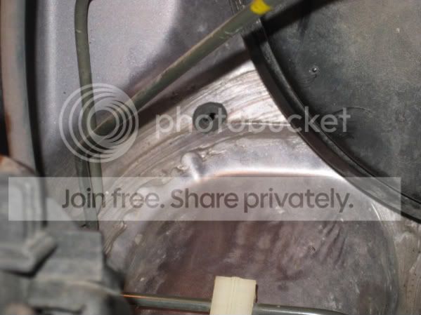

I drilled a small hole in the fire wall just above the steering column to run the wires for my trans temp guage and volt meter. It was easier then running threw some of the existing holes and i figure i will be using it again with up coming projects.

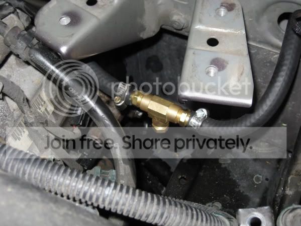

For the transmission temp sensor I purchased (1) brass tee, (2) brass 3/8" dia. hose fittings, and (1) 3/8 -> 1/8" npt thread adapter and spliced it into the exiting flow of transmission fluid. This allowed me to simply thread my sensor into the Tee fitting without tapping into the transmission pan.

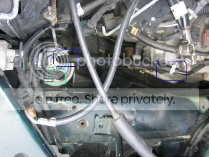

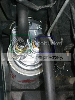

The rubber hose on top is returning to the transmission and the hose on bottom is exiting the transmission... (this is what i understand so please correct me if i am wrong)
this shows the sensor, the black wire runs to an engine ground the white into the transmission temp gauge to provide the temp reading

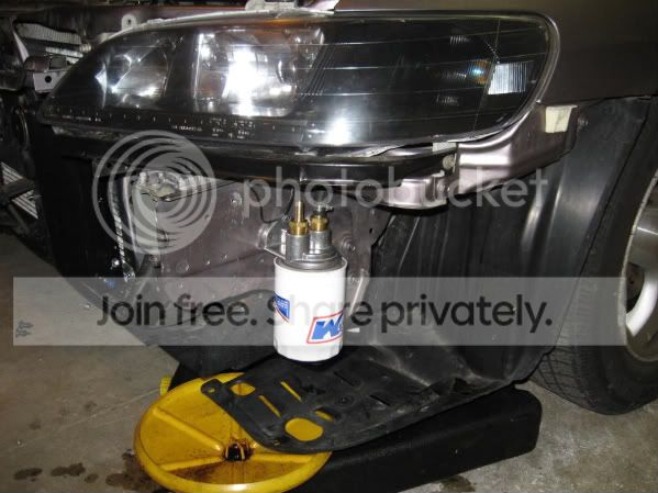

After everything was installed. Overall the project was not to hard I purchased an addition 3 feet of transmission hose and used that for the filter installation. I will take some better pictures of how I attached the cooler and ran the piping.

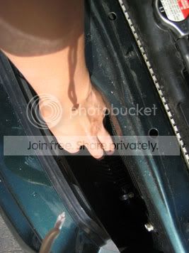

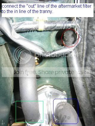

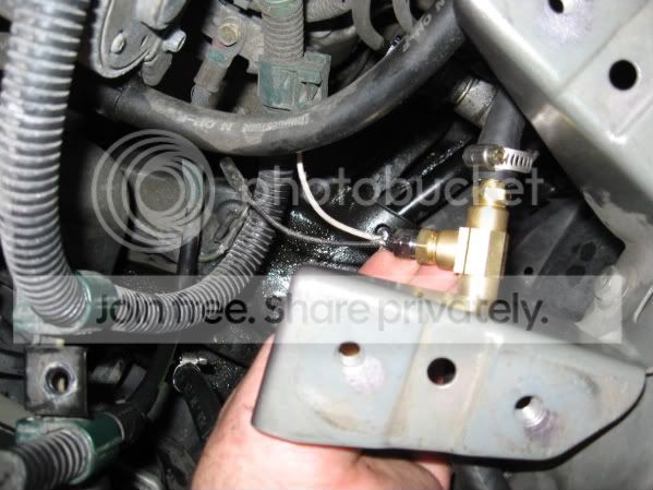

First Remove Battery
