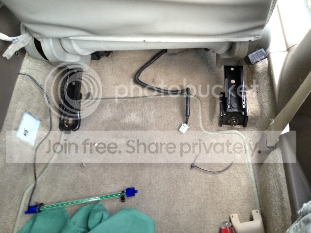

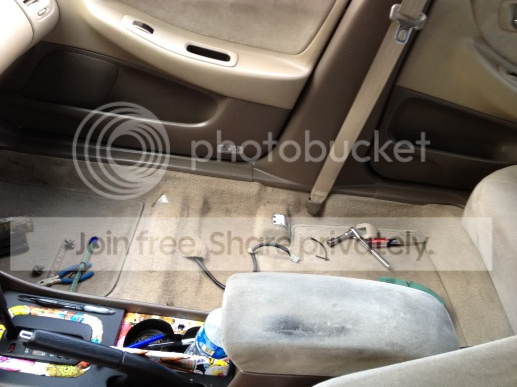

Seat out!

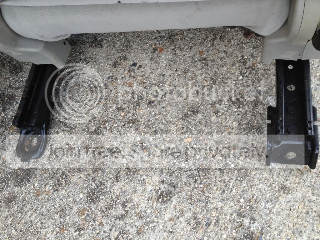

Accords Rear Brackets

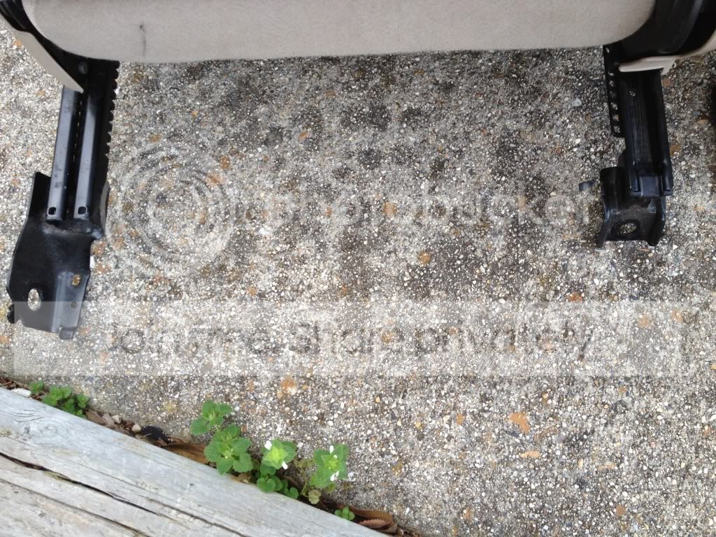

RSX Rear Brackets

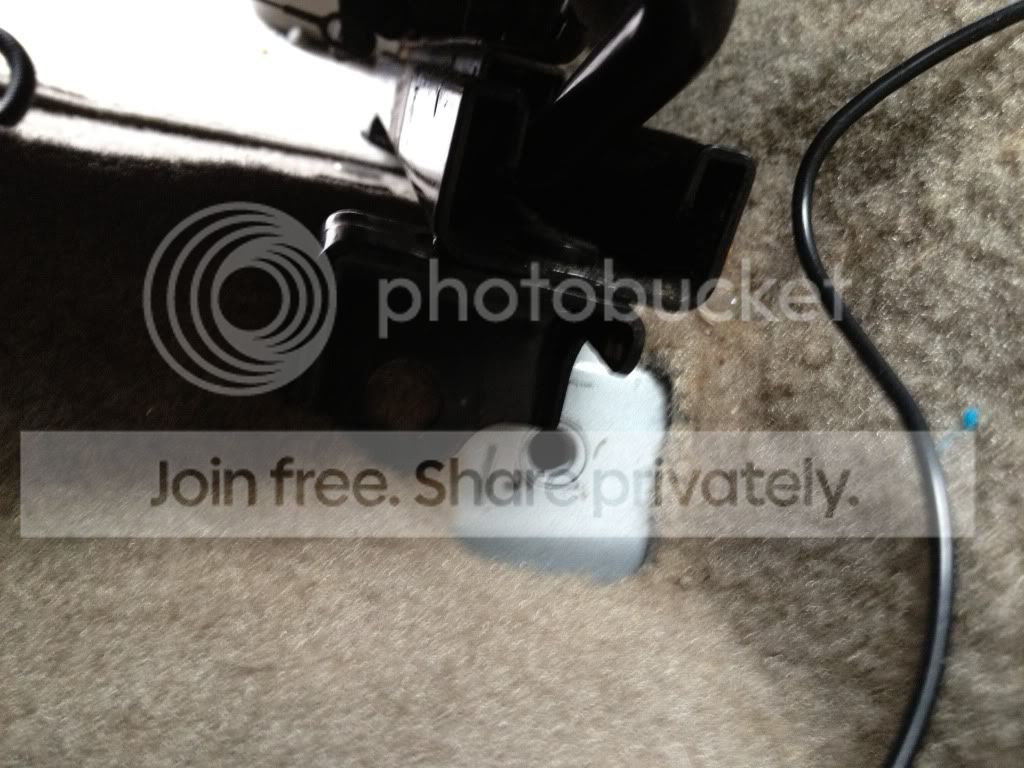

RSX in the CAR (Rear)
As you can see the left rear bracket is very very different from the accords. i have to cut the left rear bracket off the accords so i can get it welded to the RSX rail so i can just bolt the passenger seat up. But worked out great was the Right rear bracket of the passenger seat fit perfectly so i only have to focus on 3.

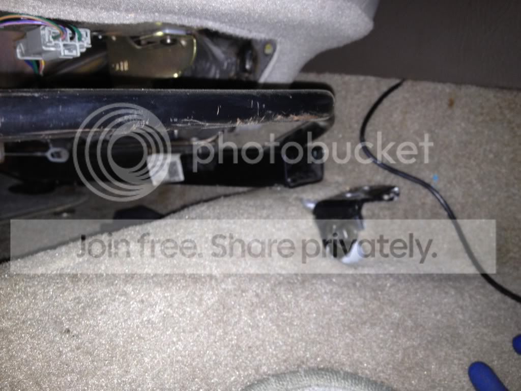

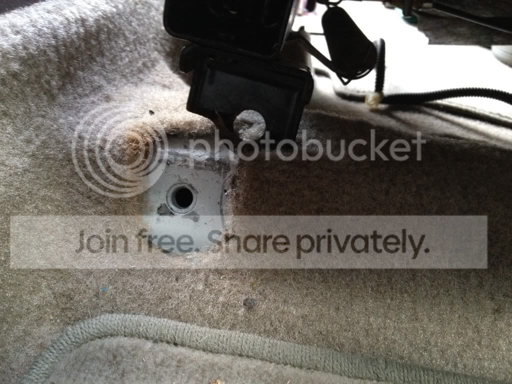

The front brackets are both a little tooo short to reach over the hump on the frame under the carpet so i have to cut both of these off and re-weld them to the rails for them to line up right. To cut these off you need to cut the little pin off the bottom of the rail and cut the weld on the side of the rail. Then get a flat crowbar and hammer down and it will slowly separate. Then grind off the rest of the metal pin and other weld left over on the rail for a nice and flat surface. (Pics to come on this)

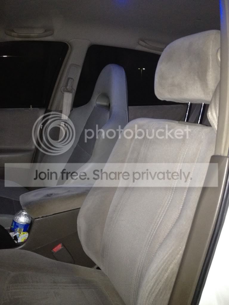

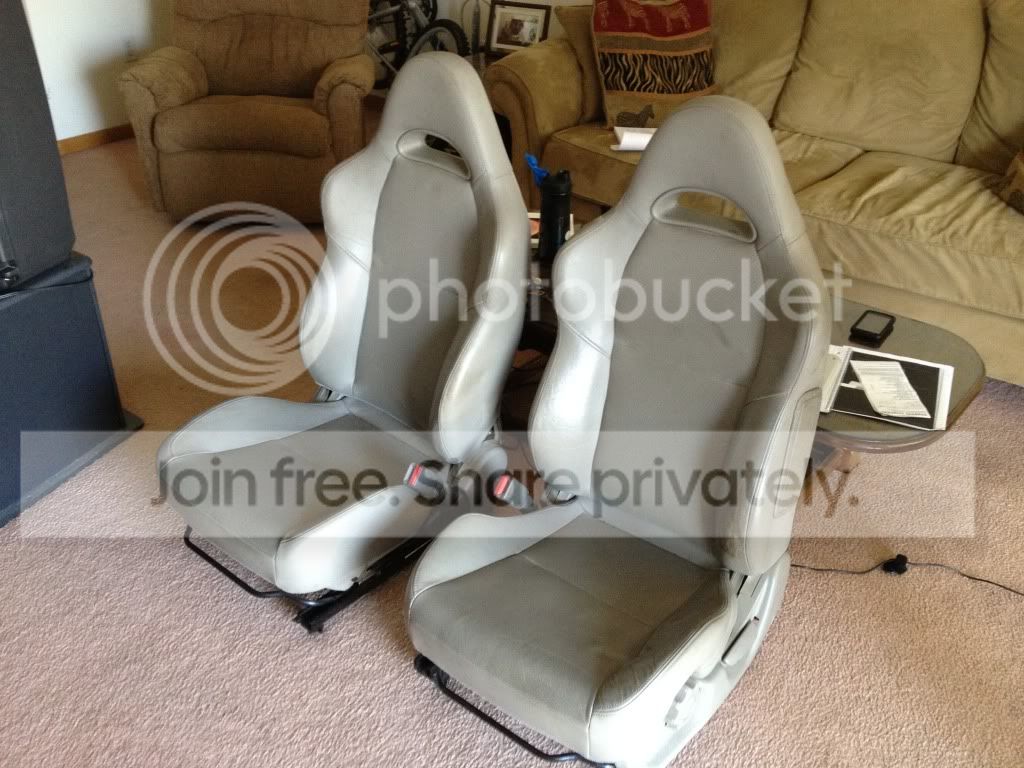

but here is the comparison between the stock seats and the RSX seats. they dont sit that much higher than the accord seats and so far it looks really freakin Sweet!! But you are going to have to switch seat belt buckles off the stock seats or but RSX seat belts because they are different and the clip is thinner than the accords!
