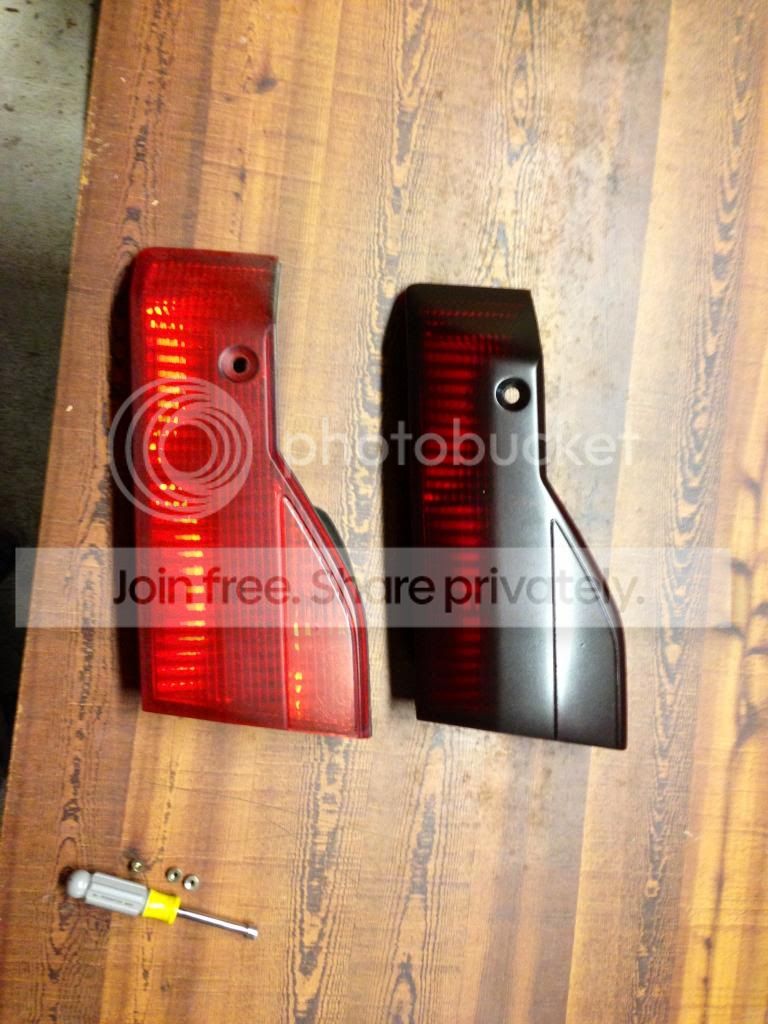

Today I started working on a set of taillights I picked up about a month ago. They had tint on them alredy so first I had to sand it off. Here was the process 80, 180, 400, 1000, 2000 all were wet sanded. With the lenses all cleaned I hit them with air compressor to blow off any debris, then a quick wipe down with a rag & some acetone.
The one on the left is after the sanding. The one on the right is with the old tint still on it.

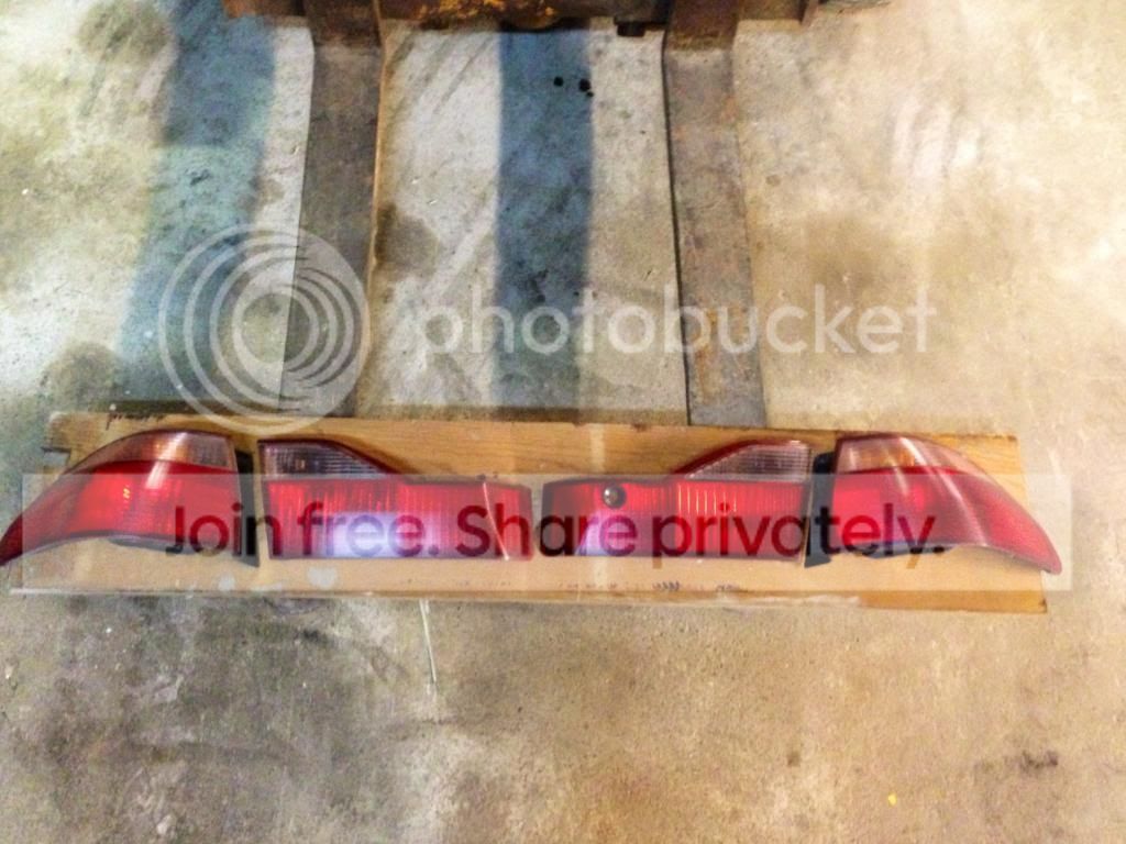

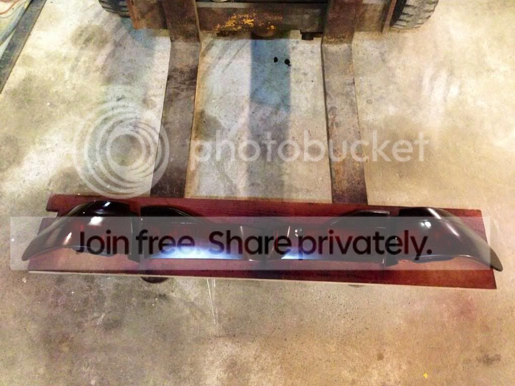

All preped & ready to go.

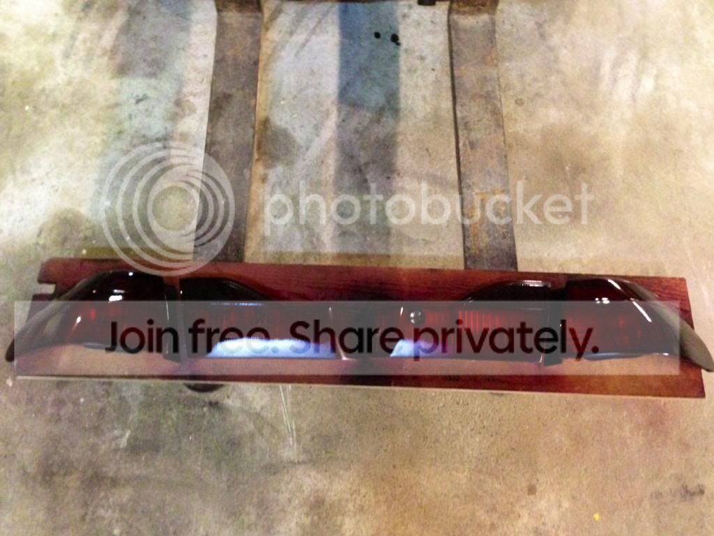

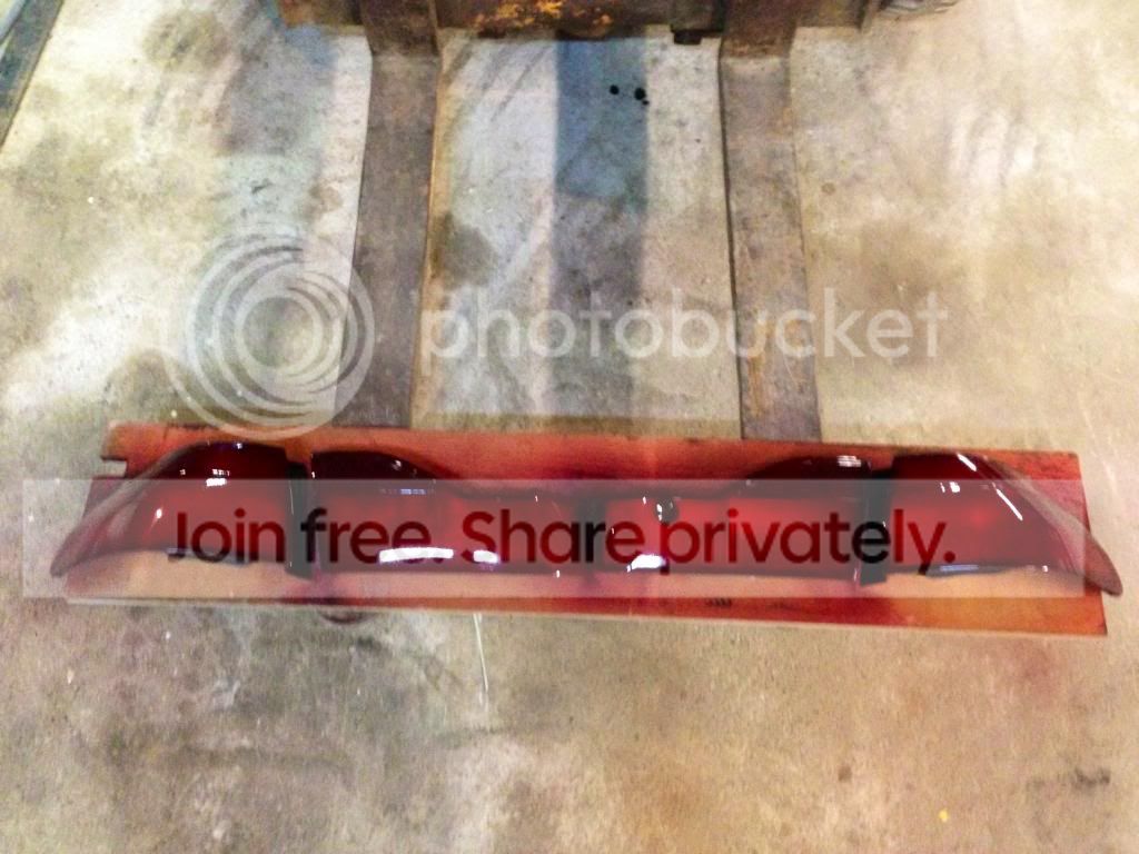

First coat of transparent red & black applied. I waited 15 minutes between coats.
Second coat of transparent red & black.
To finish it off I gave it a coat of clear. To make it more of a satin finish I shot it faster & a little further away.

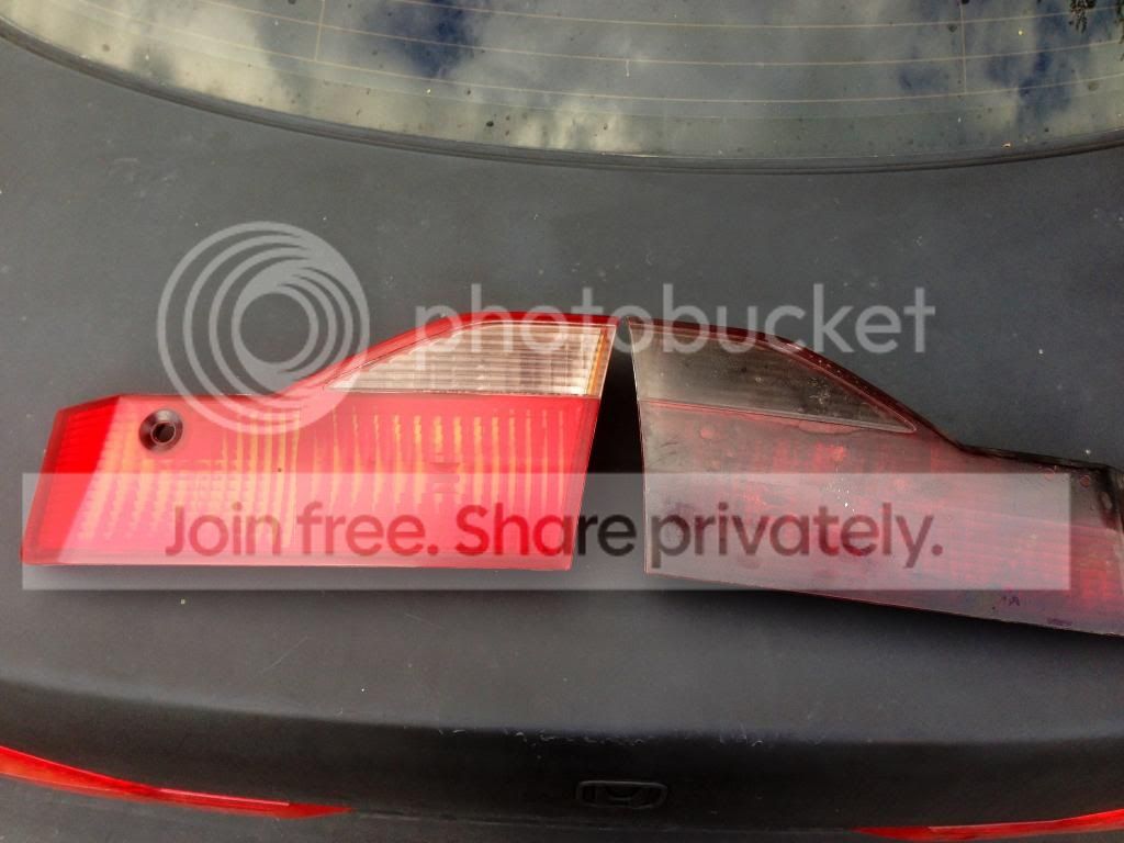

This is what the lenses turned out like compared to my old set

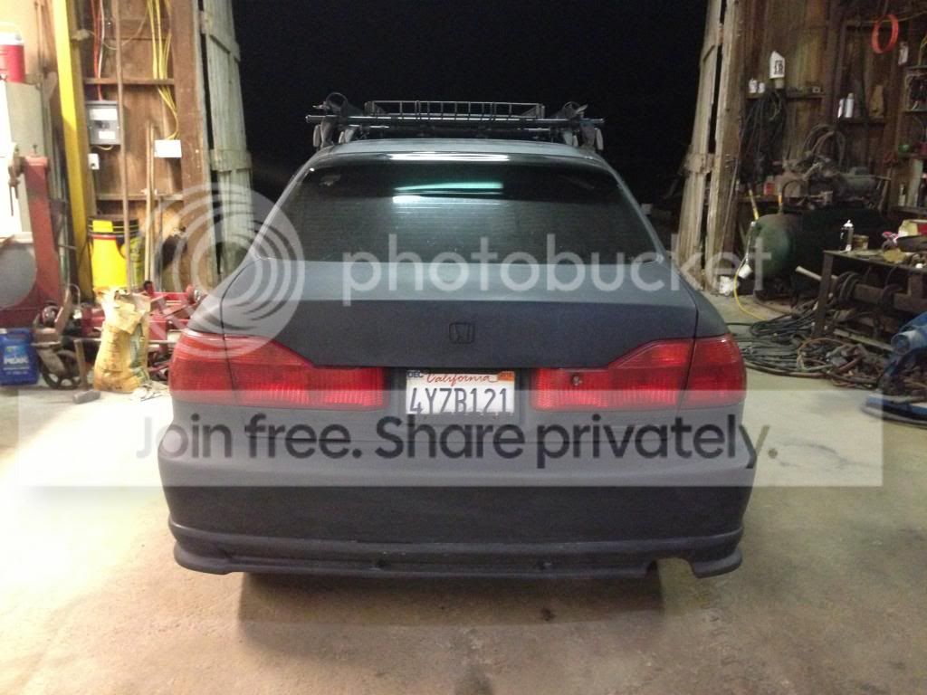

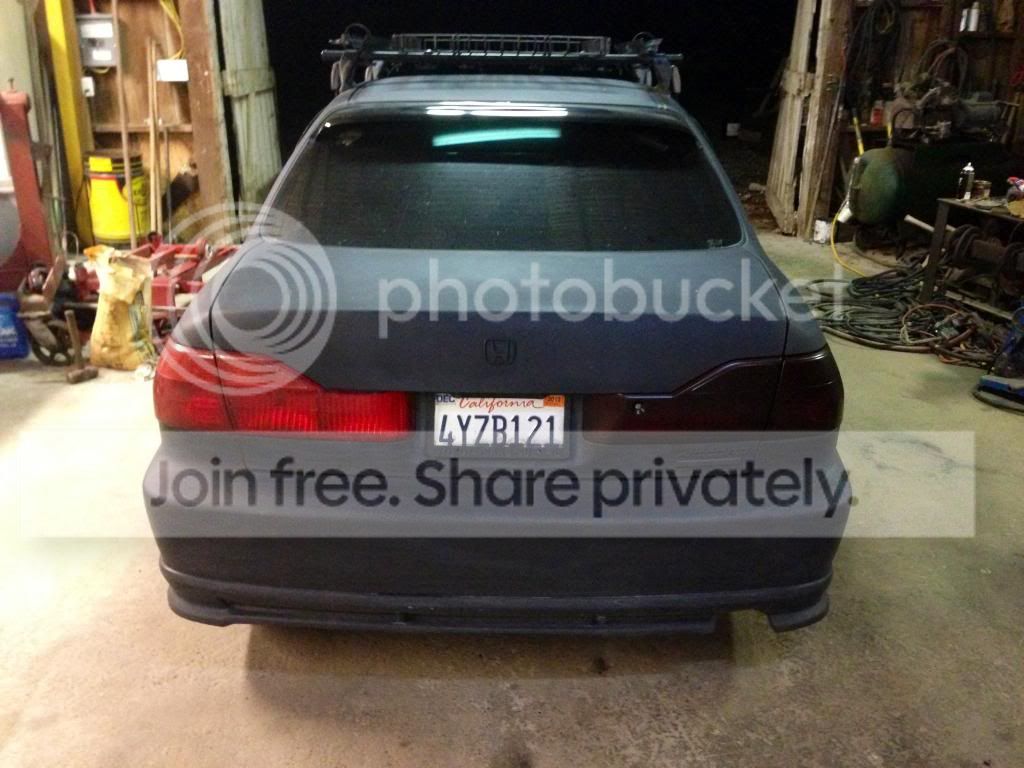

What they look like installed on my car.
It's still a tough choice both look good but I think ill rock the tinted ones for awhile.

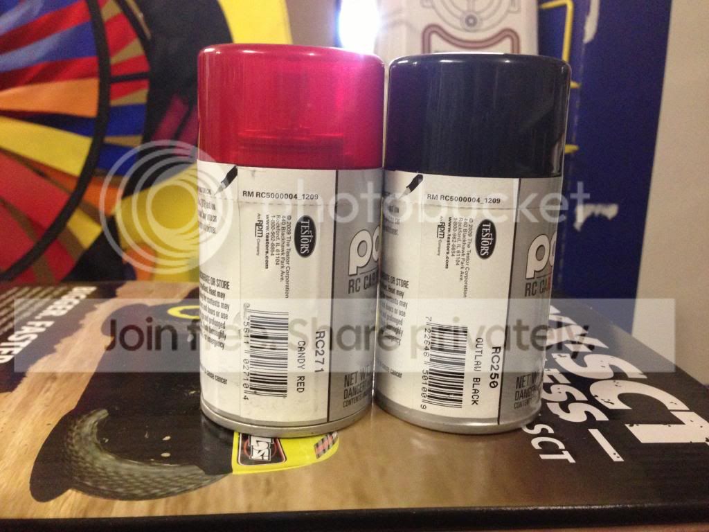

i think it turned out pretty nice, I'm glad you didn't black them out completely. that said I think i might like them even better with just the first coat, idk though. this is probably an obvious answer, but what tinting products did you use?

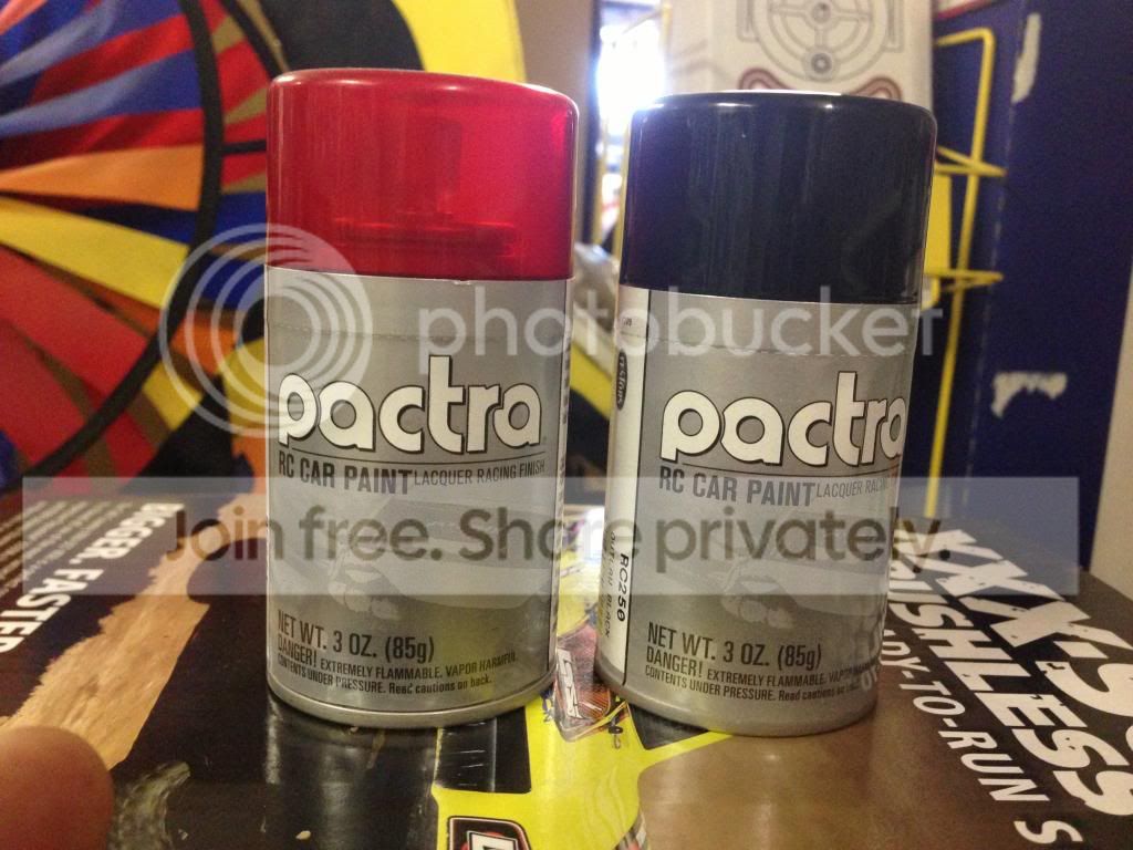

I picked up some transparent red & black spray paint from a local hobby shop. It's made for painting the shells of those little gas powered cars & trucks. Ill go get some pics of the cans from the shop because I threw the ones I used away. They have pretty much every color you can think of.

This was the same stuff I used for my other set of tails that I did in all red & they turned out great & are still holding up.
The cool thing about this stuff is that they have pearls, metallic, & neon. Check out all the colors
