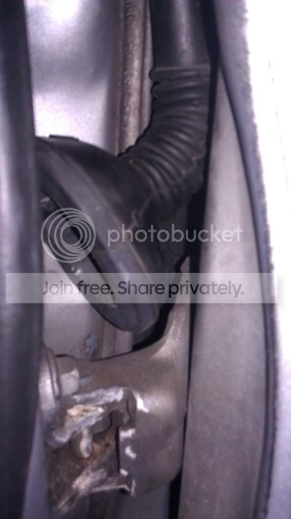

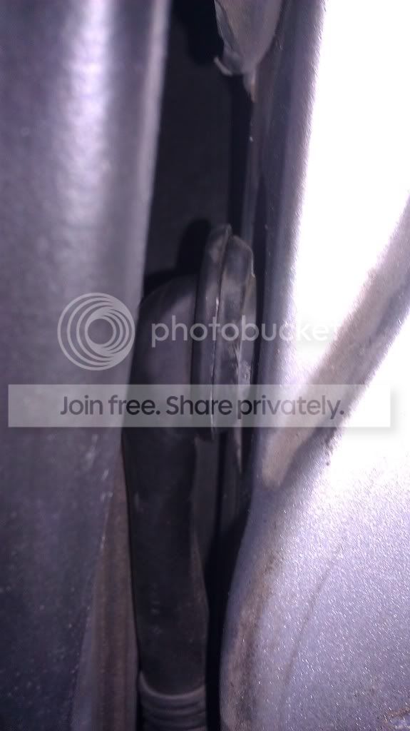

Next lets loosen up the weather thingy for the electrical cords... (best is the push it all in then pull it out slowly)

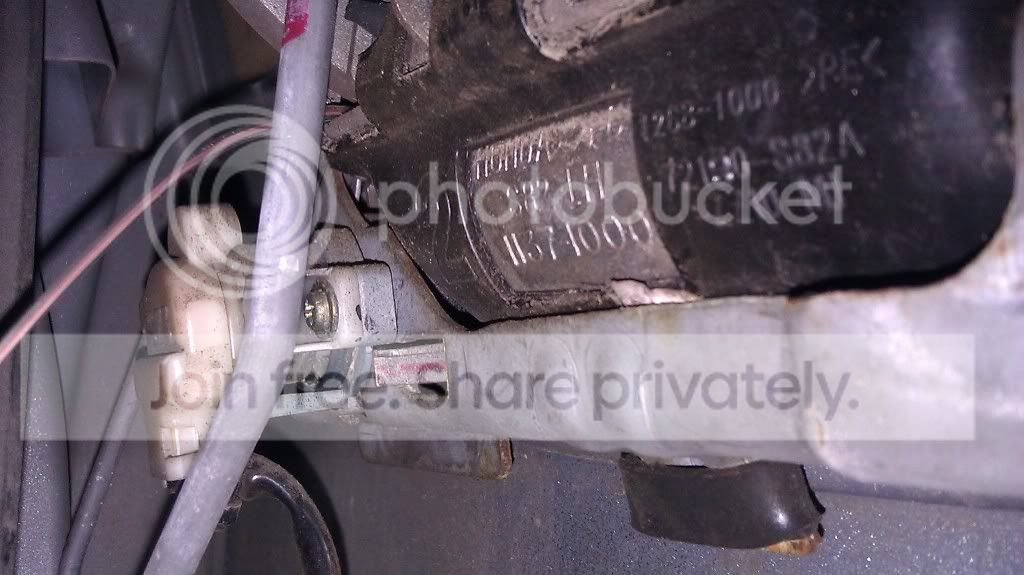

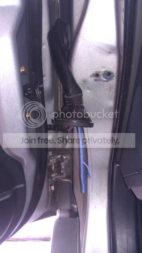

Now that we have gotten the rubber thingy off we can now figure out a way to run the wires thru... I used a zip tie and ran it thru from the inside of the car.. Much easier to wiggle its way down... (pls.. use a long zip tie. I had to tape 2 up to make the length..

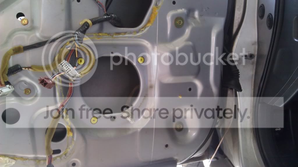

Remove the panel and remove the speakers for you to get more access to the wire..

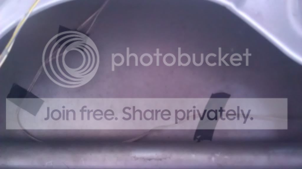

Run the wires behind the glass I chose to tape them to the door for now..

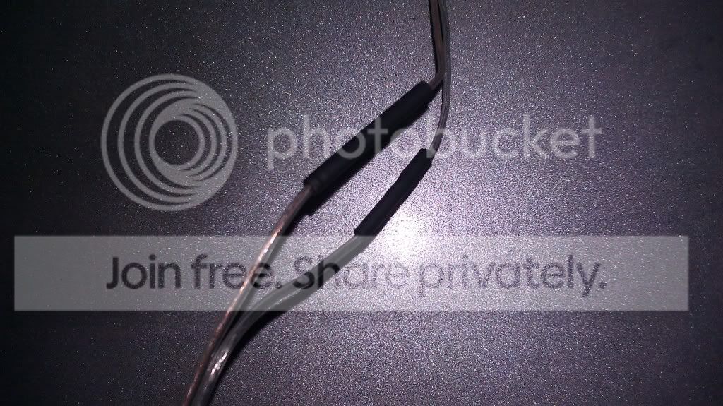

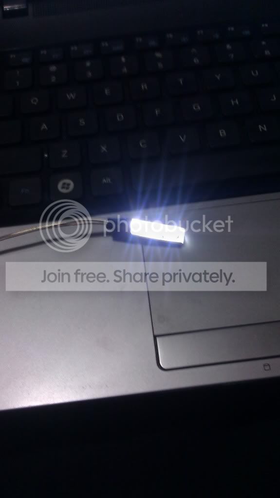

Solder them up

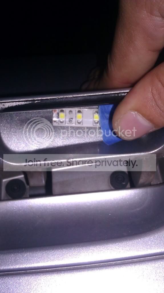

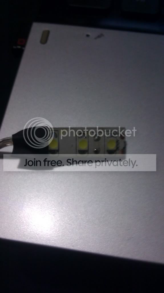

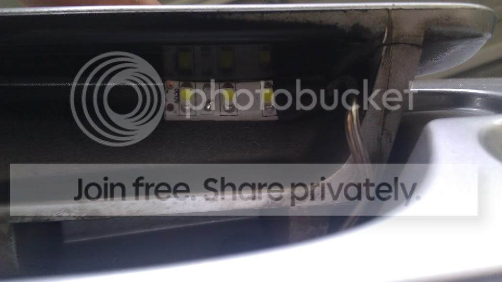

And stick the leds under the door handle..

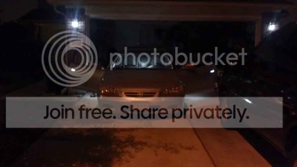

Made sure the wires are good both leds light up... and....

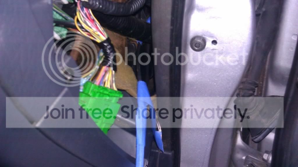

Spliced the dome wires on the passenger side panel...
