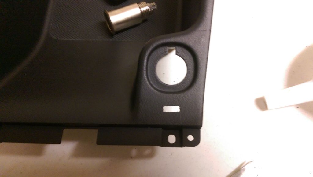

Remove the 12V socket by unscrewing the outer shell. On the backside of the tray, underneath the hole you just left (you dirty vandal), there’s a plastic vertical spine. Grind that down and grab a flash drive. Trace the outline of the USB plug onto the very center of this open space you’ve created. Then grab your drill and drill out three holes in the rectangle. Here’s how it should look so far:
Get aggressive with that drill bit and bore out the holes into the shape of that rectangle. Use your small metal file to shape it the rest of the way, going just a little bit at a time and trying to make the most perfect rectangle you can:
Keep going until you can fit your flash drive into the hole, and all edges of the hole fit snugly (Giggity):

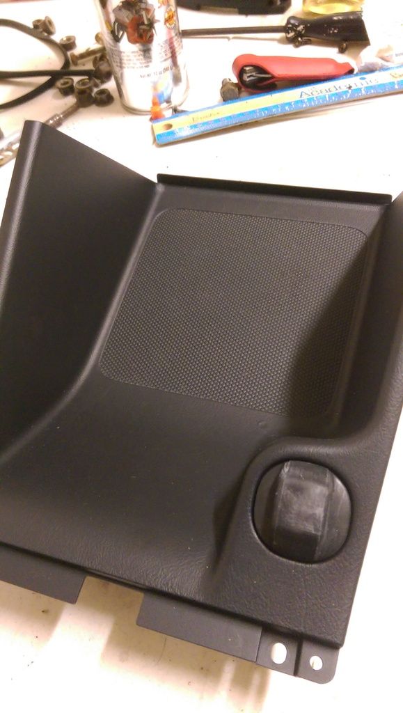

Wire the transformer to your 12V socket, positive to positive and negative to negative. You probably should reinstall the socket before doing this:
Now screw the socket back into the tray and connect the wires from the USB port to the other side of the transformer, like so:
I used hot glue to secure the transformer to the tray, as well as prevent any short-circuits:
