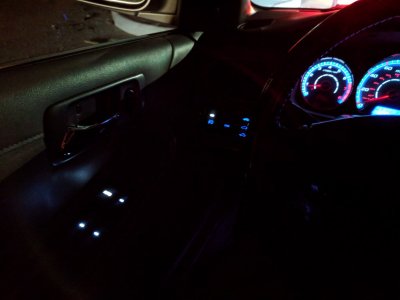

  9. statuskuo
    statuskuo Member
    Posts:
    12
    Likes Received:
    Joined:
    Jan 29, 2013
    Location:
    Katy, TX
    I got illuminated switches in my 01 accord sedan. I bought TL switches from several different 01 - 03 models at the junk yard and only the passenger and rear ones were plug and play. The master switch did not work so I took the buttons out to find that the board directly under the buttons is exactly the same as the Accord one. I desoldered the TL leds and resistors and soldered it into the existing holes on the accord switch to make them light up. I had to use the TL buttons since they had a little window for light to pass through. I don't have the stock green lights and have changed it to white leds. The switches light up with your ignition and has nothing to do with your headlights turning on or off.
    Hope this helps.
  10. statuskuo
    statuskuo Member
    Posts:
    12
    Likes Received:
    Joined:
    Jan 29, 2013
    Location:
    Katy, TX
    I don't have any other pictures but hope this gives you an idea. Mine is EX as well and had an illuminated "Auto" button so I am not sure if other trims are different or not.
