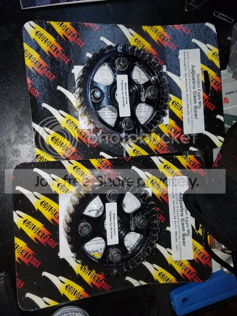

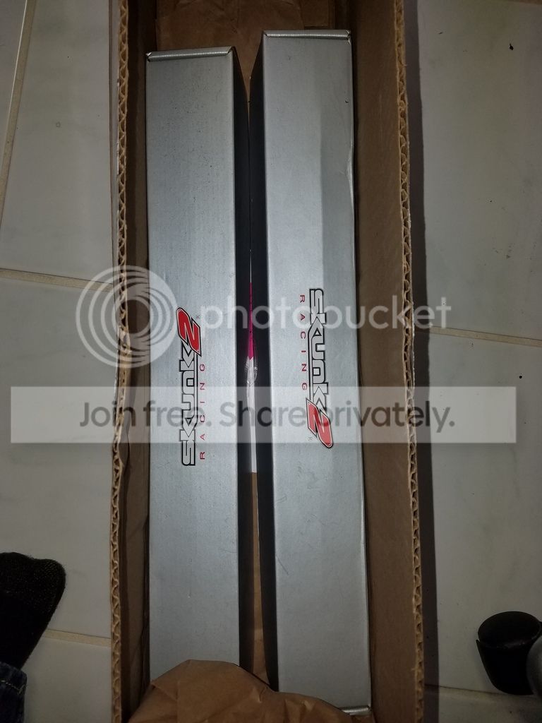

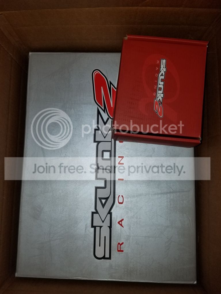

I had some new little play pretties show up and thought I would share them with every one.
BTW is it just me or is saving up buying part by part hard to do because you are constantly looking at it just wanting to put it on the car? LOL, if not then maybe I am just speaking for myself lol.

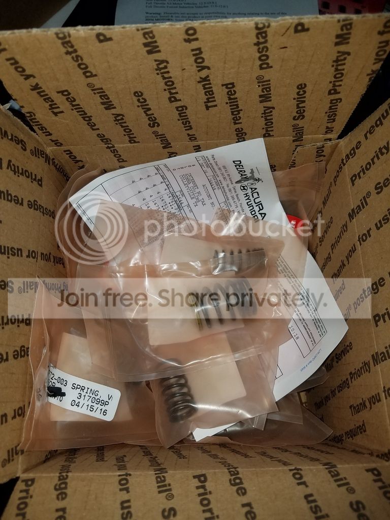

Any ways a few more parts arrived, snagged a brand new ITR valve terrain from Honda Inner and outer springs
I am waiting on a few more items to arrive while I tackle the lawn today, should be posting some more photos this evening.
