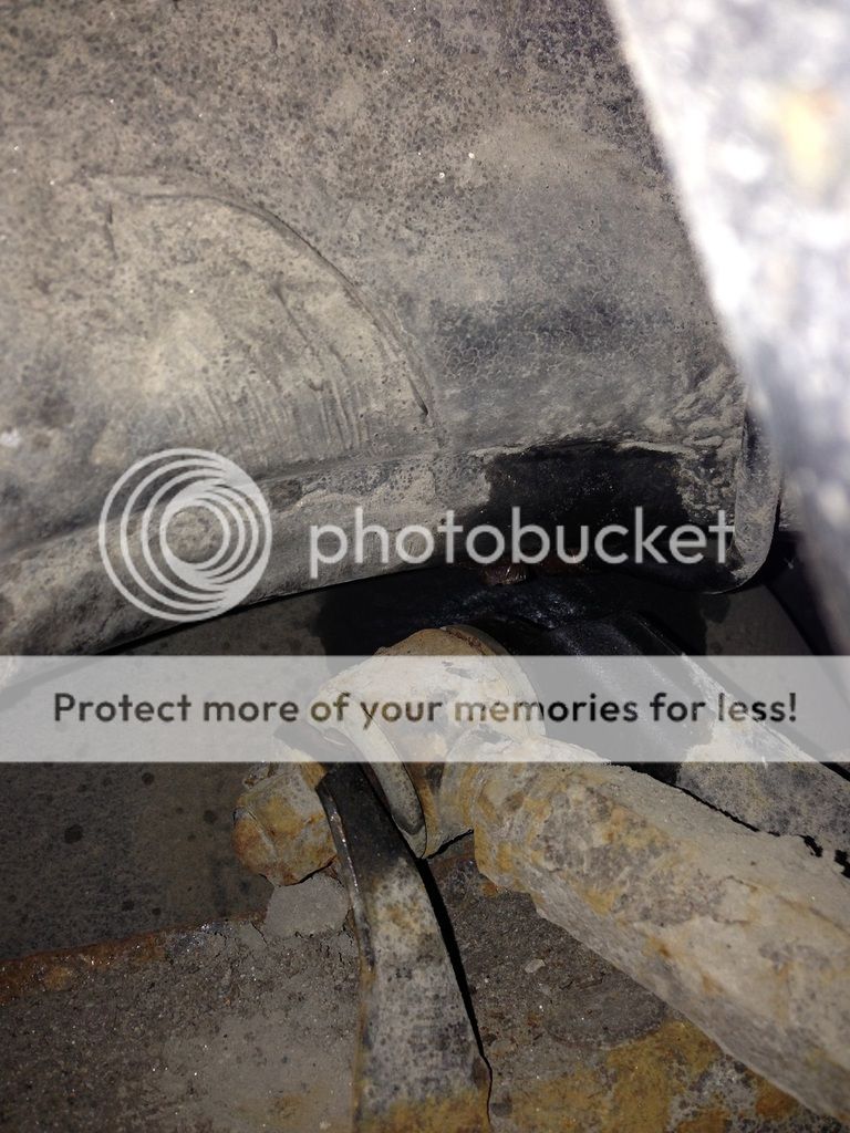

OK... I did the job but there were definitely issues... I'll post up some pics soon.

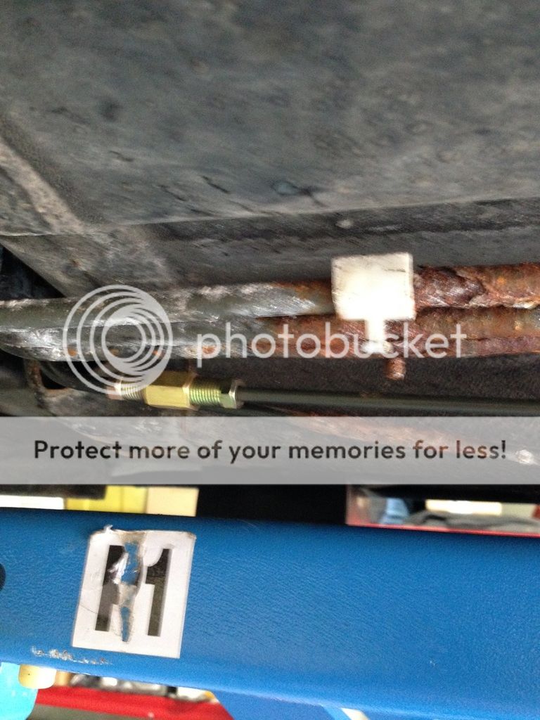

- first, getting the plastic cover off can be a challenge. The challenge is that it is holding on to all of the hard lines exactly where (and has caused) all the rust is. All of those spots are very weak and brittle at this point. Any bending of the hard lines beyond 15 degrees or so will crack those rusted spots.

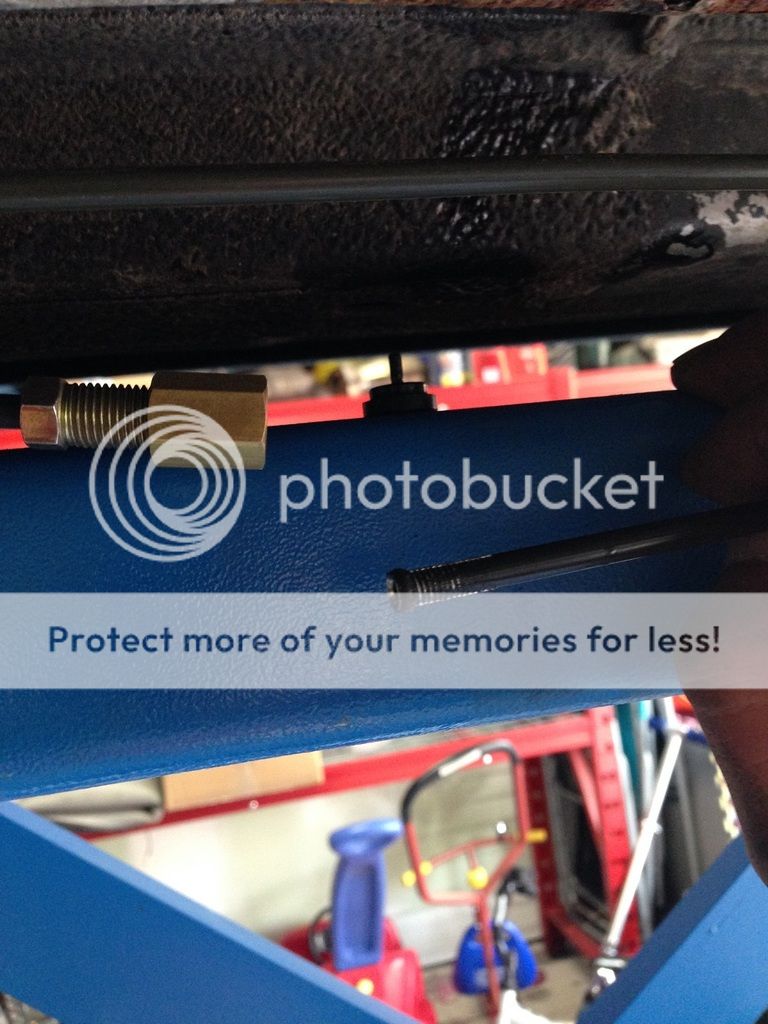

- the next challenge which if I knew before hand, I would have just repaired it... is the rear hard line holder which is the only holder that is bolted down (or up) on the underside. If your car is a 6th gen and winter driven, that bolt is completely rusted and seized. To top it off, the placement is right over the rear suspension beam and you can barely get a wrench on it. You won't be able to get the box end on it. I took a pic of that. I could have grinded down the parts in the way but I realized that even if I could break the bolt loose, I'd unlikely have the clearance to actually remove it.
So at this point I realized that there is no way to replace the entire line in one piece. I've never done a double flare but I've read and now realize from experience, that this is the right way to make a union vs. compression fittings which require no additional tools and much easier to perform.

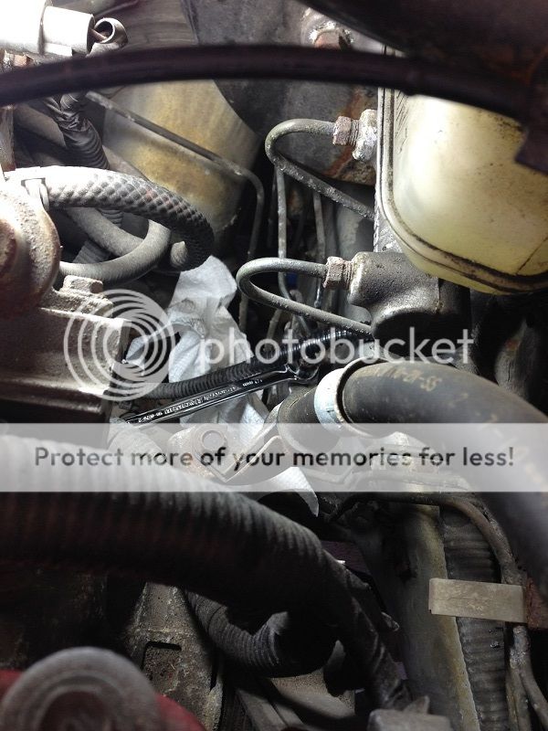

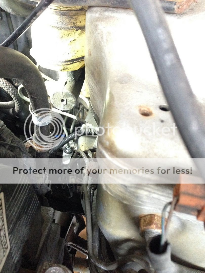

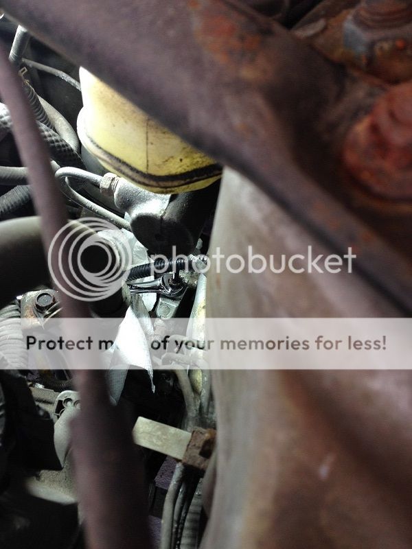

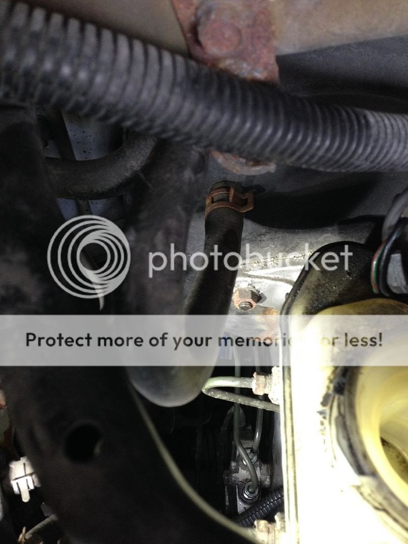

- Removing the brake lines from the proportioning valve is a pain as you can't reach it from below and it's deep in the engine bay enough that makes it hard to work with. I didn't have any flare wrenches but I highly suggest getting some for brake jobs. I used liquid wrench to help loosen the line a bit and was able to get one line off with a normal 10mm wrench... the other one stripped so I had to use a vice wrench to get it off.
- using the OEM fitting actually helped save a lot of time especially under the hood. Since it was already pre-bent, and the difficulty in reaching the proportioning valve, the OEM line was perfectly positioned and I bolted it into the valve easily.
