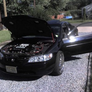

So I've been looking in the forum for a camber kit. Unfortunately I haven't seen anyone post pictures or even talk about it. So here it is. I got a 02 coupe. I recently lowered my girl and now camber is out of control. She rides good. But the stance that I like is not the one she has. So I've been searching all over to see what are good camber kits. And of course one that fits. Anyone has any ideas?

My car is really low. Like 3 inches under factory specs. I have looked at the skunk2 and hardrace but they don't have it for my car.
