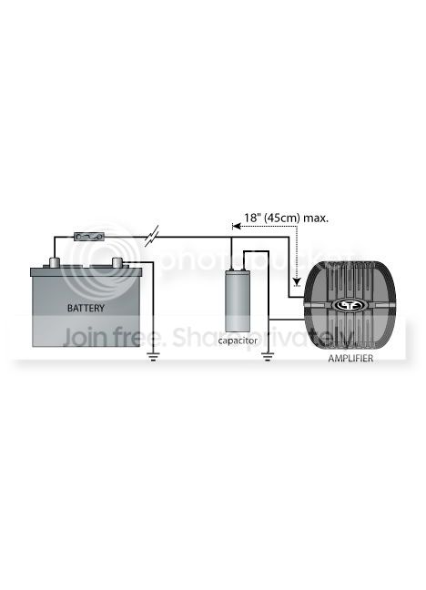

Here ya go:
Battery, into the cap, and out to the amp. Ground out of the amp into the cap and then finally ground to the chassis.

Totalimmortal said:
Here ya go:
http://i26.photobucket.com/albums/c121/everandaday363/answer501.jpg
yep, stiffening cap should be wired in parallel with the battery.
