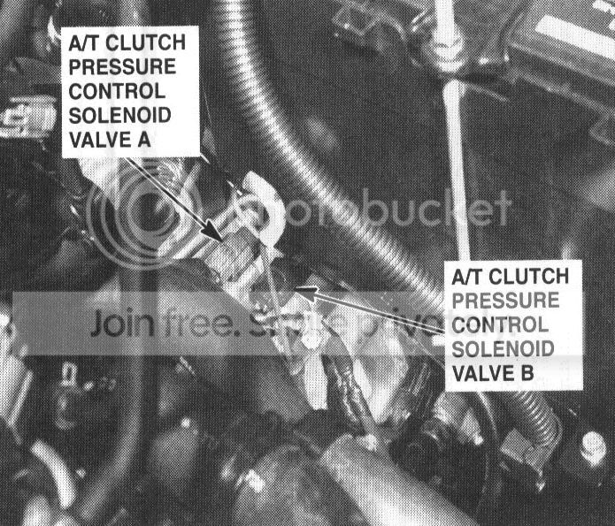

P0775 - Problem in the Hydraulic Control System of A/T Clutch Pressure Control Solenoid Valve B

i can get you replacement instructions, as well as testing instructions with it still on the car, let me know what you need. pretty easy fix if this is the problem, could just be clogged up, i remember mine leaking a while back.
