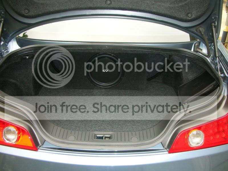

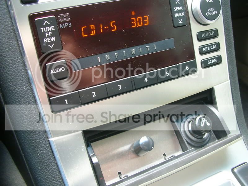

Well I've been going back and forth with what I was going to do with the stereo in my g35 and I finally made up my mind. I'm putting a elemental designs sq10 subwoofer in a fiberglass enclosure in my spare tire hooked up to a mtx amp thats coming in the mail. I going to use the speaker level inputs on the amp (not thrilled about that) hooked up to the back speakers. I don't want to change out the headunit because it costs like $350 for dash parts I need from japan and I would have to get a double din because the single looks really bad in that car. The amp comes with a remote bass knob so I'm going to mount that in the ash tray cubby. I have the spare tire all taped up and I'm going to do the fiberglassing tomorrow after work. I'll post up some pics as I progress. :thumbsup:

I ended up doing 2 layers of fiberglass last night, I going to do another layer tonight. I had to bring the spare tire in the house because it wasn't warm enough for the fiberglass to dry properly.

Finally did my install last weekend. I ended up ordering a custom box made by elemental designs to my specs. I covered it with carpet from yourautotrim.com. The sub I painted flat black and I put a infiniti logo decal that I got from ebay. The mtx amp is under the trunk floor under the left side plastic. The ashtray piece I made at work for the remote knob. Overall I'm happy with it, I decided on going with a oem look. The sub is great, I'm impressed with elemental designs.
