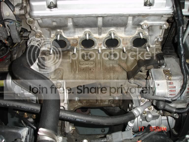

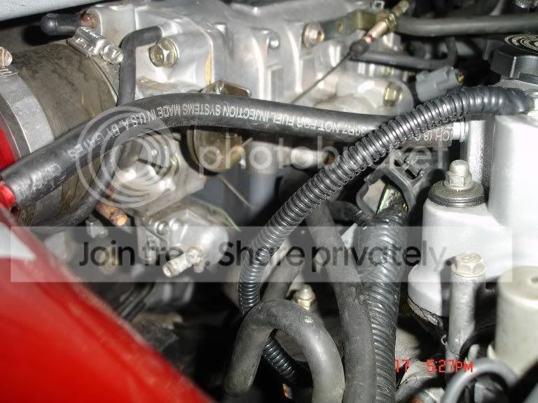

throttle body & blacktrax im stackers

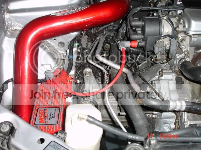

prelude aem intake & msd 6al w/ss blaster coil

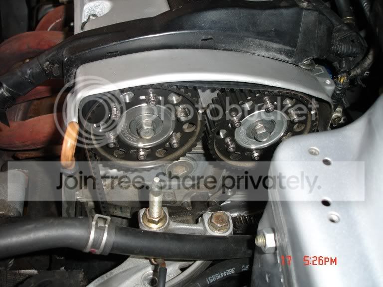

type s cams wit skunk 2 cam gears
