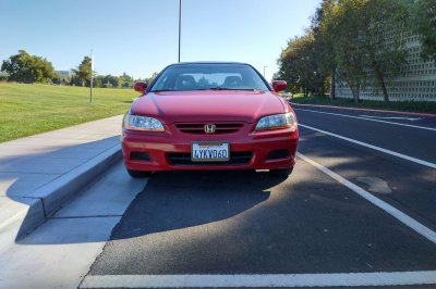

I used to drive a 2002 Accord Sedan EX V6 AT in Firepepper Red Pearl. Bought it in 2009 at 30K miles and drove it to 193K. I found this gem on Craigslist at 47K miles at a great price! So I decided I had to jump on it and keep the 6GA life alive.
The original owner kept it in good shape with regular oil changes, but never performed other maintenance or exterior/interior care. It's going to take some TLC to get it into presentation condition, but excited to see where it takes me.

Here are some photos shortly after purchase.

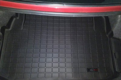

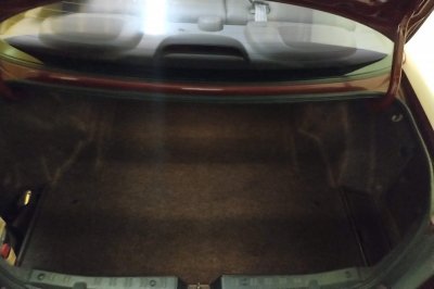

I put in a Weathertech trunk liner the other day. Something I always thought made the trunk look a little more put together.

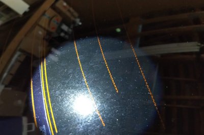

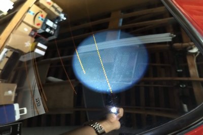

I realized all the glass on this car is covered with etched water marks, so the past few days I've taken ~45 minutes every morning to experiment with cleaning techniques, going from gentle to more aggressive. First I just tried spraying and wiping with Windex like a mad man, thinking it would just come right off. I tried claying it, and also no good. So now I'm up to using some #0000 steel wool with some glass cleaner, and that seems to make a little bit of progress on it. I'm thinking that's the just the right amount of abrasion I need, so when I have some time, I'm planning to spend some time on all the windows slowly working through getting these water marks off, then rinsing/washing the car off to avoid any steel wool particles from wreaking havoc on the paint.
Will post some before/after photos if I remember.

Detailing update: My first pass of all the glass has cleaned up quite a bit of the etching, but will have to return to them to clean up heavier etched areas and corners.
Before
After

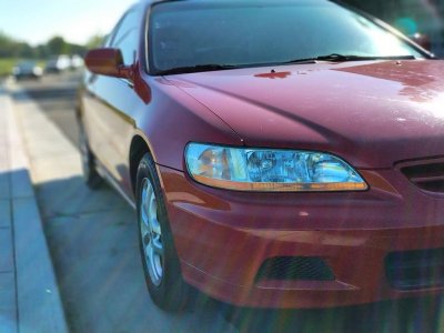

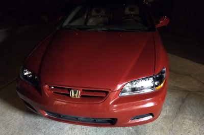

Replaced headlight assembly with something a little sleeker a couple nights ago. I also found these original 9006 halogen fitment LED bulbs, which I haven't seen in the market before at a great price. Light distribution is great!

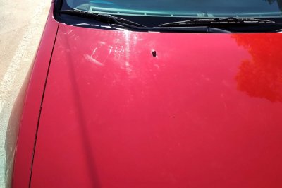

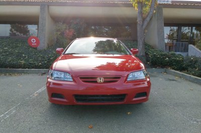

Another detailing update. I spent somewhere around 10 hours on a paint detailing job (wash, decontaminant spray, clay bar, compounding, polishing) to bring this car's paint up to a decent viewable condition.
Definitely a lot of micro-scratches, and some bigger scratches that I didn't have the guts to try to chase because I don't have a paint gauge to see how much clearcoat I had left to work with. Compounding got rid of the water marks on the paint pretty easily though. Afterwards, I applied a ceramic coating from a very promising, low-cost brand, and I have to say I'm extremely satisfied with the results given the cost. I gave my car a double coat, and still have nearly half a bottle left, so let's see how long that ceramic coating lasts.
A couple before and after photos just so you have an idea. Sorry, I'm not a great photographer and I always forget to take photos that really showcase what I've been up to. The after photos are taken just before I went in to the local Red Cross center to donate some platelets.
BEFORE:
AFTER:
