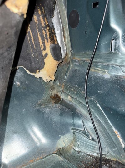

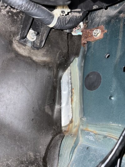

Hello, im brand new to the forums and I have a 1999 accord ex. Currently I have a pesky leak when it rains on my front passenger floor. I cant see much from inside the cabin because of everything in the way but the water trails down the very far right corner of the passenger footwell. I have taken my carpet out and fixed the drain tubes bc they were leaking. I replaced my windshield and the surrounding area as it was very rotted under the windshield and water was getting in through there. However im still getting a little bit of water. Iv heard that a couple other posibilites could be water coming in from the cowl area or just old body seal failure somewhere. I plan on trying to diagnose more with the weather getting nicer but if anyone has any ideas or things I can check I will appreciate it all and I will keep you guys updated on my findings thank you!!
