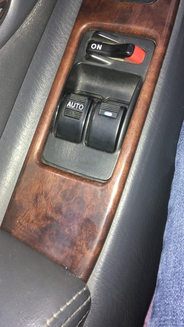

Hey cg4ever, not sure if you got this figured out yet but for the window switches on my sedan I had to use the button caps and LEDs from a TL and use the same board from the Accord. The TL board did not work since there's memory seats, heated mirror and other misc stuff linked to it and is considered another multiplexer. What you have to do is to desolder the led and resistor from the TL board (or get new 3mm LEDs and the right resistor size) and solder it on your Accord board. There are holes and markings on it already. Since the switches do not have a light window, you'd have to use the switch caps from the TL. You just have to pull it really hard up and it'll snap off. In your case it might be all CL stuff but the same idea. The "AUTO" button is a bit more yellow so if you plan on doing white LEDs keep that in mind. The buttons will come on as soon as your windows are active with ignition. The passenger side was plug and play for me. If you use the window lock, the lights will turn off on the switches.
I am looking into getting some illuminated mirror switches and I heard the ones from the first generation CRV and some generation civics work so I'll update when I do this. Right now I'm in the middle of several projects so it'll take some time.
Hope this helps.
