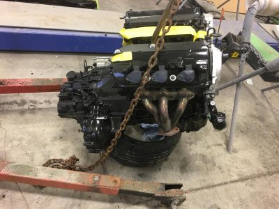

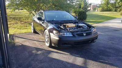

New to the forum thought I'd share build details and DIY thread.
Car:
2000 Honda Accord coupe (v6 chassis)
197k mi.
Blown automatic 4 speed (blew Diff on nitrous pull)
Ex trim, full leather and sun roof
Engine Build:
J35a4 long block
J32A2 heads
MDX oem 3.7 crank
P2R snout spacer
Acura MDX j37 rods
J32 custom made Wiseco pistons
Oem valves
Supertech street springs and retainers
Ported and polished intake and runners
Transmission:
08 TL-S 6 speed LSD with 07 Accord bell housing
P2R 6 puck with Spec stage 3+ PP
Fuel:
525cc FIC
OBX fuel rails
Aeromotive fuel pressure regulator
Electronics:
Custom fabbed j30 harness (stock harness rewired)
AEM v2 ECU
AEM wideband
Supporting mods:
P2r hallow clutch line
S2000 master cylinder
CL-S slave cylinder
90a innovative motor mounts
500hp insane shafts
CL-S shift box with jtc customs short throw

Nice build. Would love to see photos and/or hear info on how you dropped the TL LSD into the 7GA 6MT trans. If I'm reading that right.
j35_cg2
Active Member
Dec 10, 2016
32
Cleveland Tennessee
The gearbox is the TL-s (from the j35a8 2nd gen bellhousing) the newer 2nd gen bell housing was removed and a used 7ga 6mt bell housing was used to be bolted to the TL gearbox if that makes sense. It's a TL-S trans with a replaced bell housing
j35_cg2
Active Member
Dec 10, 2016
32
Cleveland Tennessee
But also any j series lsd will work in the 7ga trans. They are all the same. You just have to know how to open the case and replace the differential
j35_cg2
Active Member
Dec 10, 2016
32
Cleveland Tennessee
^Yea that's what I've heard, I've just never seen anyone actually do it.
I work at a body shop and we have huge discounts on lkq parts and junk yards and I managed to find the tls and 7ga transmissions for 500 a piece so I snatched them both. I do not have any pictures of the bell housing swap as I was rushing to get the car back together and I didn't take pictures or document the auto to 6 speed conversion like I am the complete restoration of the car. But the swap is pretty easy just need to reseal the cases after you pull them apart
