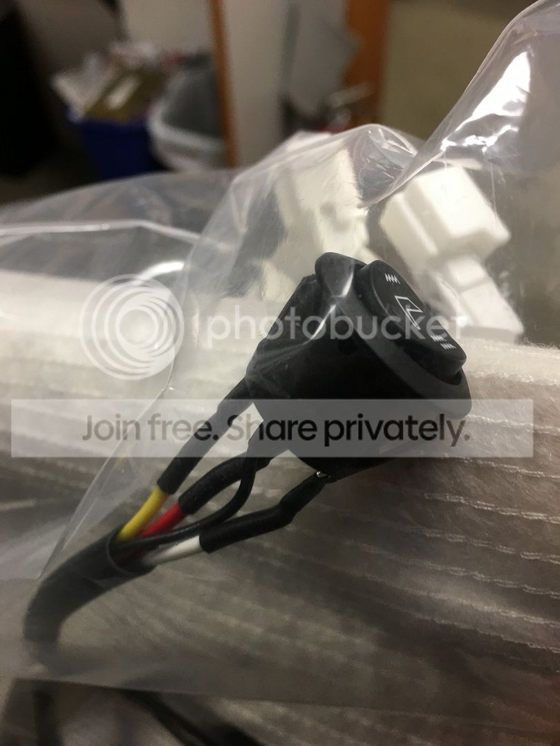

Wondering if anybody can help me here. I have aftermarket seat warmers in my car. They came with all the wiring, relays, etc and a switch. The switch works just like stock one we have. 2 different levels of heating. The switch on the aftermarket seat warmers has 2 wires coming of it. Those wires coming from the after market switch basically are used just to send a signal saying which setting it is on. Which two wires on the oem switches should I wire them to? I'm hoping people are following what I am saying. Perhaps I can get a picture of the aftermarket wiring harness if need be.
Also need opinions. I want to do full 2.5 inch exhaust (keep my cat) to dual 3 inch blast pipes. (Example: Isis blast pipes). No resonator? I know it will be pretty loud, but really how loud? And will it sound super ricey? Remember that I will have the h22 in it.
Here's a pic of the switch

Figured out that wires 1 and 6 (red and white/black) are hot, 2 and 3 (black and red/black) are ground, 4 and 5 (white/red and white/ blue) are the high and low settings. Should be pretty simple to wire. Hopefully.
