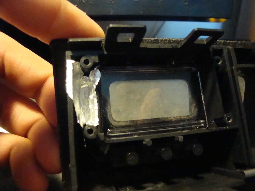

Pardon my thickheadedness, but i'm not understanding what the foil is for.

^clock LED size is 3mm.
The foil is for bouncing the light around more inside the housing so more of it gets to the diffuser. I can confirm that this does work, it greatly improved the brightness of mine. Idea of placement:

The bulb is aimed inside that compartment on the left, with the diffuser to the right of it, so the bulb is not directly aimed into the diffuser. Which is why every time someone converts their clock to LED, it gets dim because the diffuser is not catching much light from the LED. This greatly helps that.
And as I said earlier, it helps to get an LED with a diffuser around it instead of just one with an LED at the end of it facing out. If there are any radial firing LED's that are 3mm and would fit this application, those would be even better I think.
