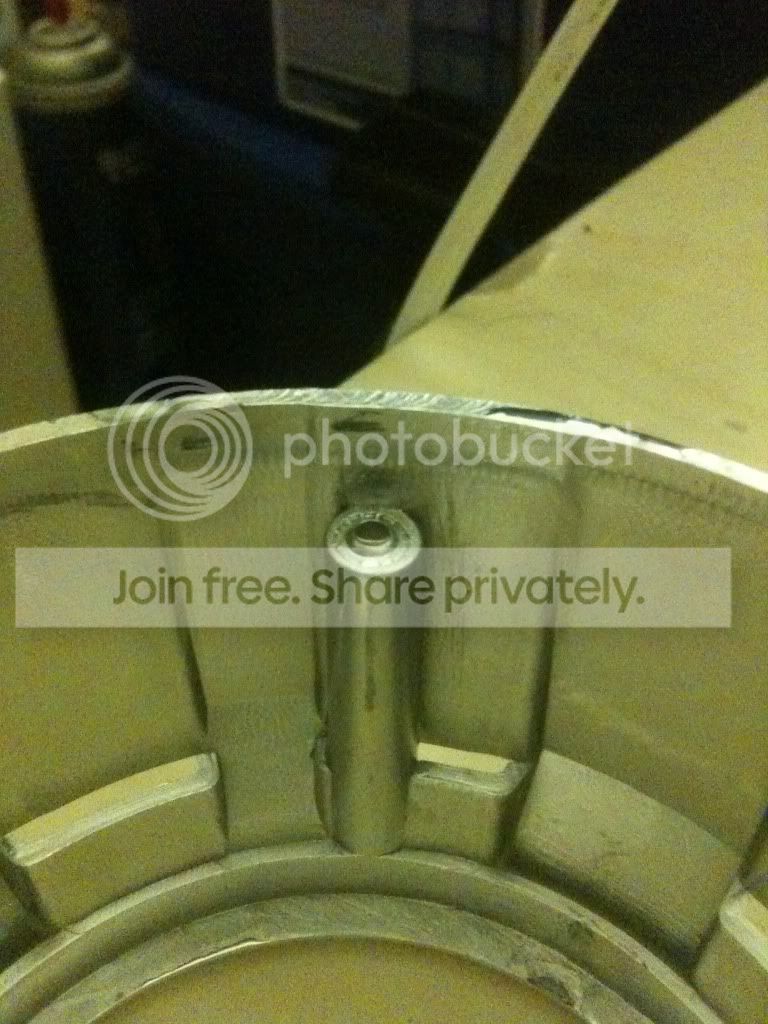

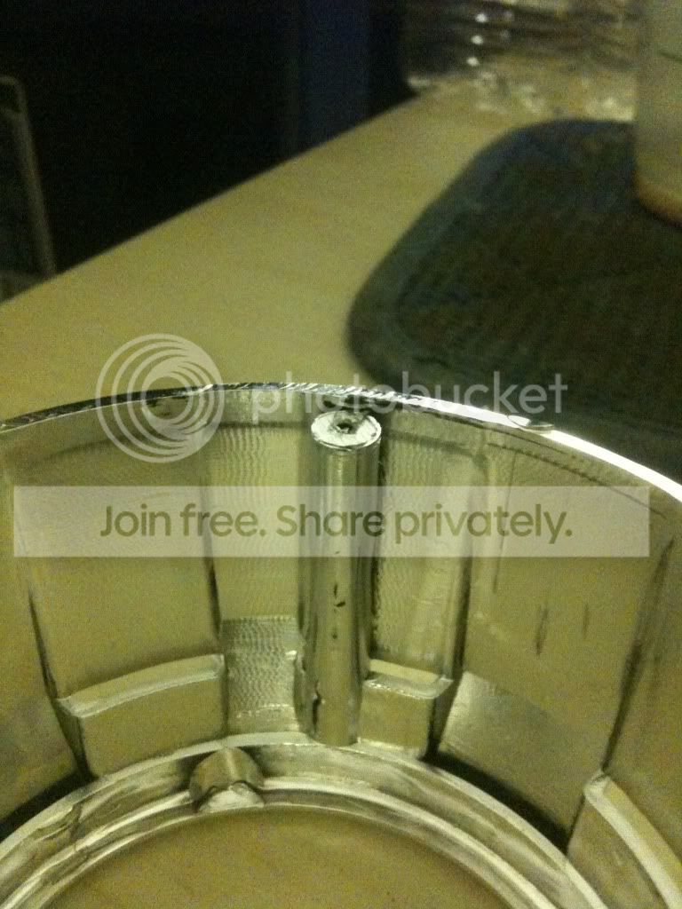

If you look into the back of the mini gatling gun shrouds, there are 4 posts that stick up towards you. These are for the 4 mounting screws. I found that the posts ran into the projector housing before it was completely seated. So, with a cutoff wheel in the Dremel, I cut them down by 3/16". This allowed the shroud to slide farther back onto the projector. This was enough to clear the lens.
This:
