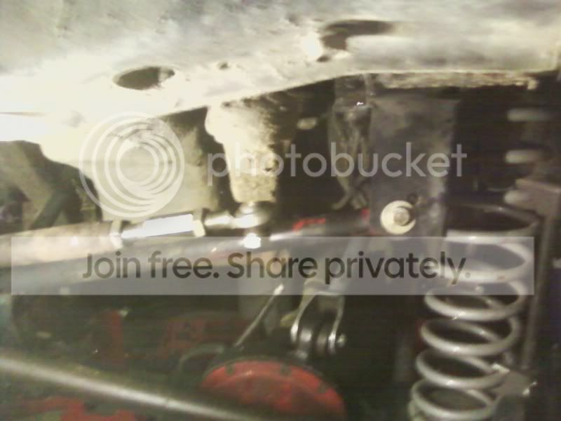

Well I've been busy. New front axle /coils/steering is done.
Rear is mostly mocked up and waiting on me to get out the welder and start finish welding.
Here's a picture of my new steering/trackbar.
5/8" chromoly rod ends with grade 8 hardware all the way round, 1 1/2" DOM tubing makes up the draglink and tie-rod, .5" wall with threaded adapters welded in.
You can see my shiny new-to-me upper control arms in there as well.

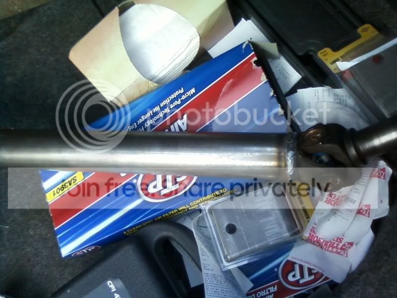

so, more work this weekend. Got my new rear axle hung under the frame, just need to mock up ride height, set the shackle angle and burn the mounts to the frame.
after that it's a harmonic balancer, a brake line I tore up on the front end, and making a new rear driveshaft and it's ready to wheel.
I have pictures, but my phones being stupid and won't mass storage to my PC.

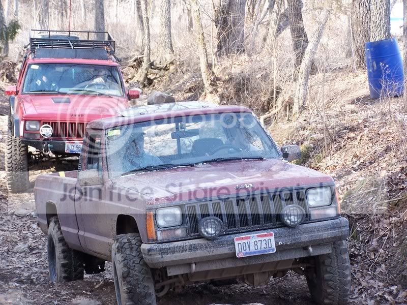

Picture that surfaced from my club event @ Flatnasty in 06.
back when it was still looking like a truck.
