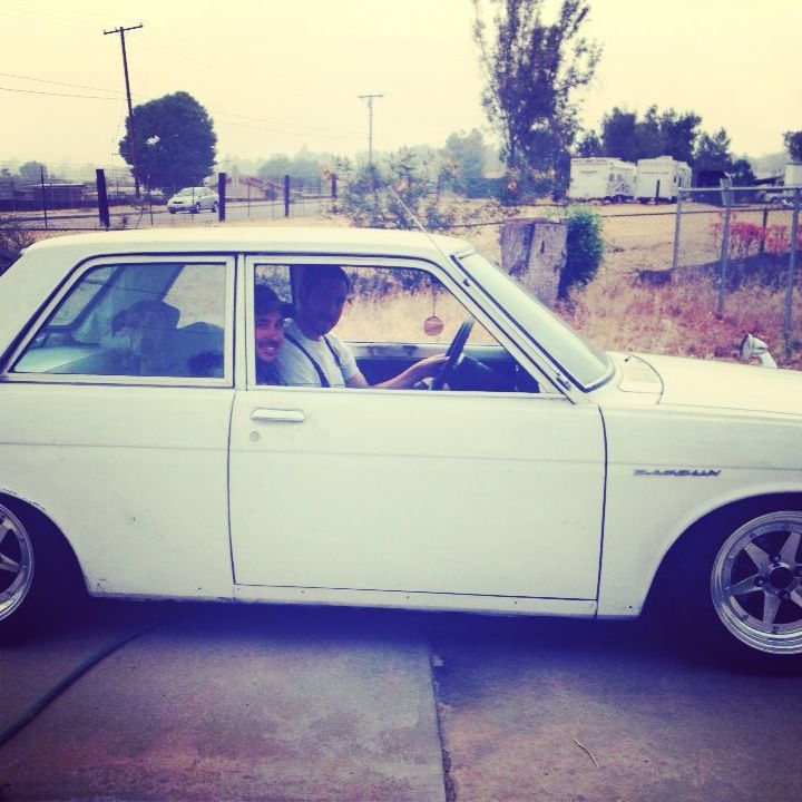

Put 72 miles on my '72 dime :)
Took my brother in law and Zooey home
