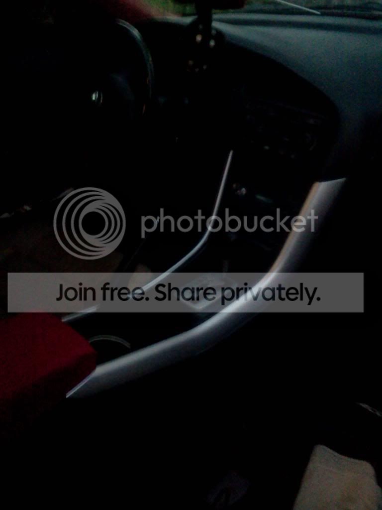

i think i used krylon household silver metallic paint on my acura trim to try and match the oem stuff, looks alright but i think it needs a satin clear coat, might be a bit brighter than what you're looking for.
