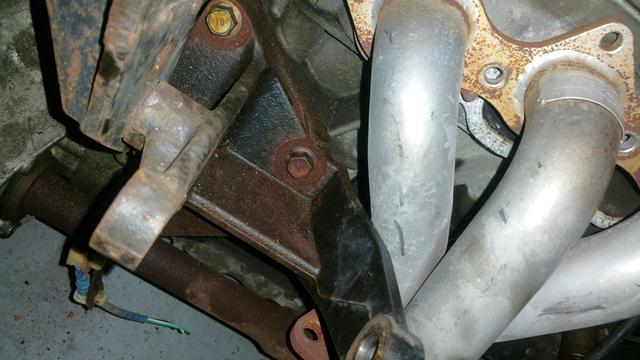

I used my headers for the v6 auto. I grinded the rear mount bracket a bit to make it fit. I don't have an after pic, but you can see where it hits. I grinded it so it comes in and out with no issues.
