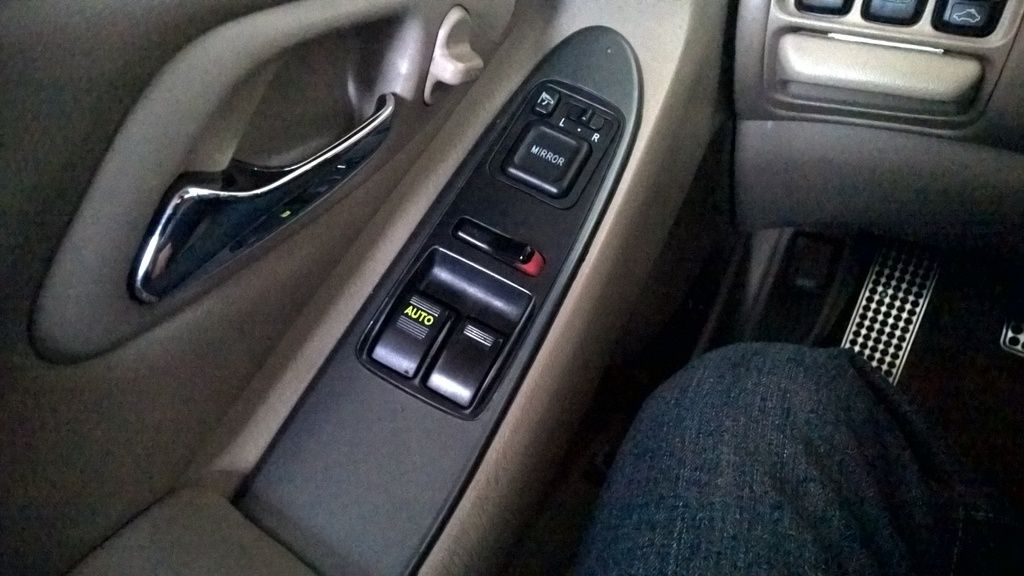

So I take it the switches are from an 01-02? That's awesome that its a straight swap! I figured a different harness would be used so it wouldn't be a straight swap!
19,557
138
Re: RR's 3.2L '99 EX-L Coupe 6MT
Yep, straight swap other than having to use the switch assembly from the 98-00 on the 01-02 trim on the passenger side. I didn't have to do that on the driver side which surprised me. Easy though as they mount the same way.
It seems the 01-02 switch assemblies are just stripped versions of the 98-00, All you have to do is remove a piece of black pastic trim from the 98-00 and it's basically identical to the 01-02, which makes the swap easy.
I just have to change out the bulb so the AUTO text isn't puke green. Not sure what color the MIRROR text will be on the PFM switch as it is out of a JDM Civic (EP3 I think).

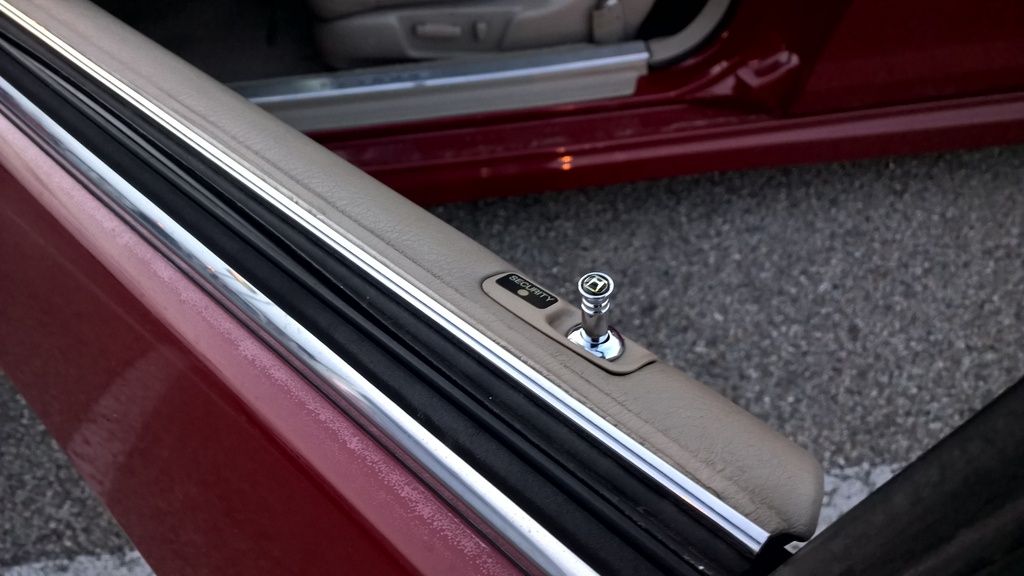

EDIT: Test fitted some polished door lock knobs yesterday, not sure how I feel about the 'H' emblem.
Don't mind my failing clearcoat. :lawl:

I'll pass on the lock tabs. :lawl:
Pics of the switches at night..?
And it's weird you didn't have to do a lot of modding to the switches. It's been a minute but if I remember correctly, when I switched mine over from the gray to the woodgrain, I had to virtually gut the driver switch and use the 0102 innards with the 98-00 trim piece. I don't remember how hard the passenger side was but I remember the DS being the big PITA. And I lost the lighted function. Didn't see a bulb. If I did, it wasn't one I could "replace". :shrug:

^Hmm I had to do that on the passenger side but driver side was plug n play. Anyway here is a photo with AUTO lit up (on the 98-00 switch I think it is just printed), I don't have the PFM switch wired yet.
I like that polished knobs match the pull handle and the CL window strip, and I think it helps the interior look/feel more upscale personally. But between the 'H' and the trim ring in a square recess, I can't quite say I love it. So I think I am going to keep looking for something else, really what I'd like is a chrome/polished knob similar in size/shape to OEM. But aftermarket companies always have to overdo everything. :rolleyes:

Couldn't tell, if you didn't mention the clearcoat haha. Since the "security" letters are facing outside, maybe you can turn the H that way as well?

Yeah I actually did turn the 'H' after I took that photo, sharp eye on you as always.
