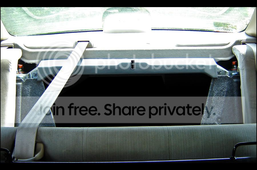

if you cut the ends off of that plastic piece that goes across the front of the rear deck when the seat is folded down, you can reach the adjusters by only folding the seat down. that's what i did with my last sedan.

If you remove the rear bulk head cover / cut its both ends like Sketch o5's, it's never pita, as you can see his pic.
Idk if its a sedan/coupe difference, but my Tein SA, on my coupe, sits a lot taller than your adjusters.

I didn't trim off the piece. Sketch o5 did. But, a hack saw will do the job. if you're lazy, a dremel tool w/ one of those blade spinner bits will cut it off like a butter. Iirc, the bulk head cover piece had to be removed in order to install the coilovers, so I'd simply leave it off tho.
