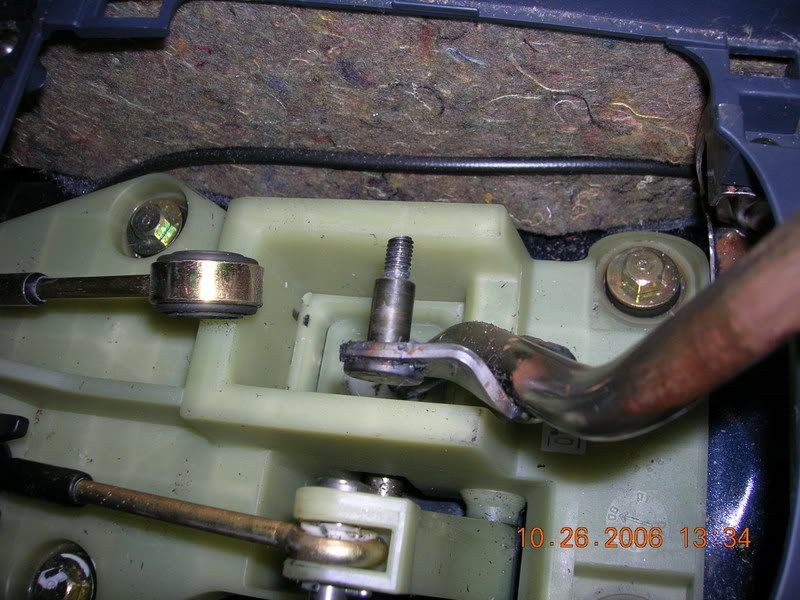

When you first remove the center of your console, this is what you're going to see:

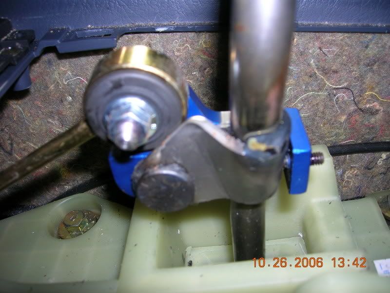

You can see where the linkage currently attaches to the shifter itself. The first thing you do from here, is remove the nut with a 10mm ratchet or wrench and remove the linkage from the bolt. The shifter will now sit freely.

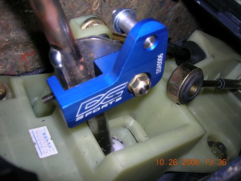

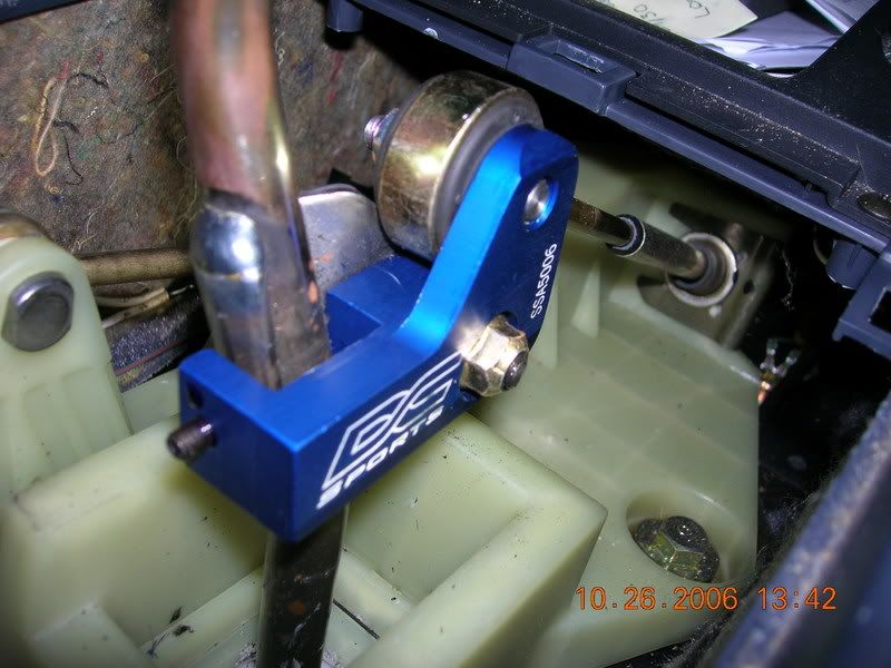

Next, the adapter that I got (DC Sports) has a hole in it that will allow it to slide onto that bolt and around the shifter itself:

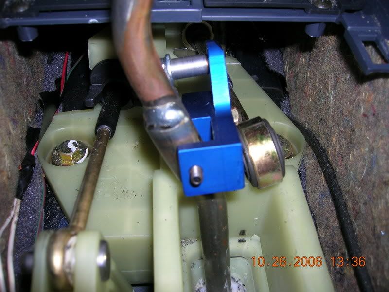

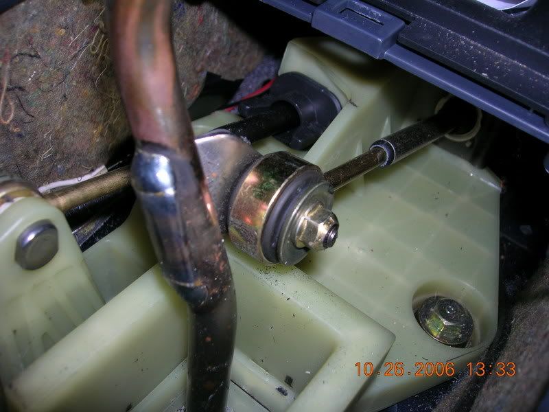

Next, attach the linkage to the obvious spot on the adapter. I found it easiset if I didn't have anything tightened up yet (even a little bit) even though the instructions said so, because the linkage wouldn't slide over a piece of original metal from where it used to attach and the DC Sports adapter, so I slid everything on relatively simultaneously, which seemed to work better than it sounds. Then, simply add your Locktite to the threads where the linkage attaches and the allen screw is:

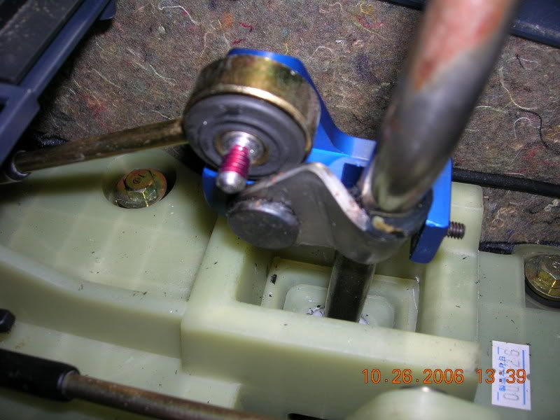

Tighten up the 2 bolts, and the allen screw until the adapter doesn't slide at all. Here is what it should look like:

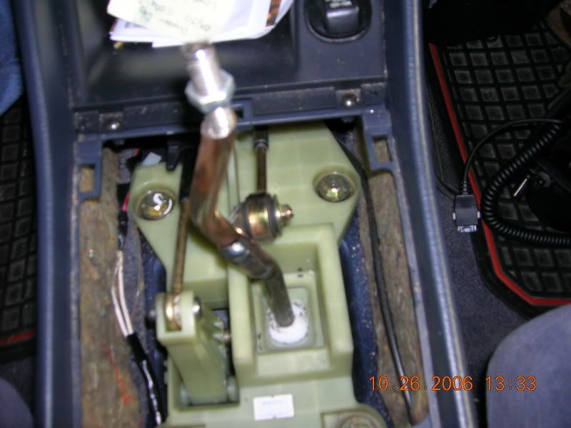

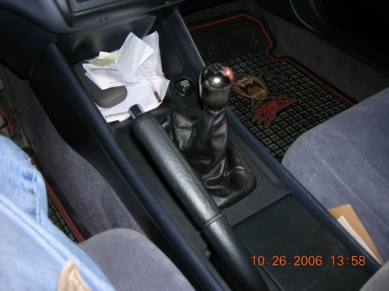

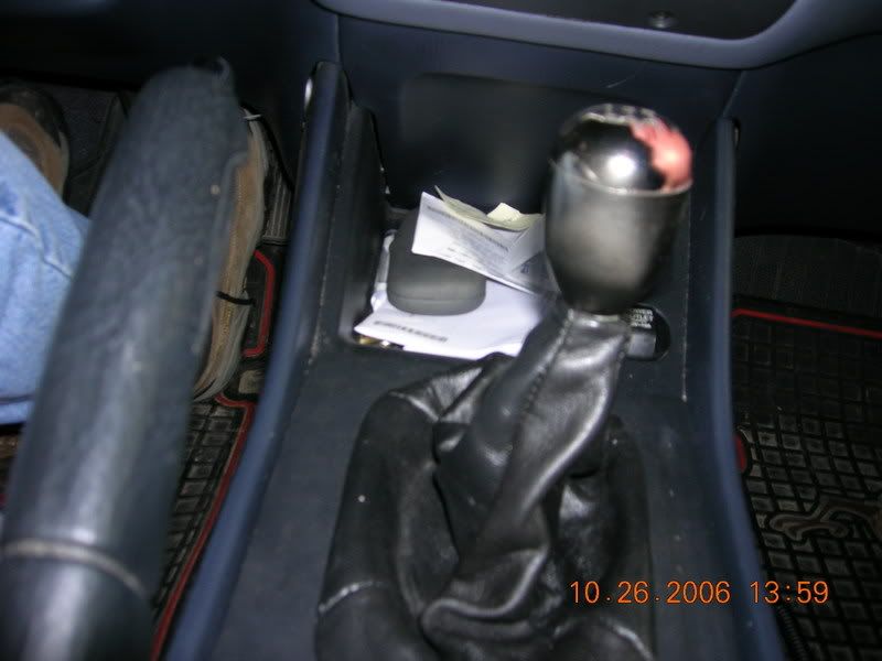

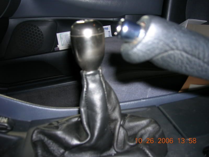

And replace your center console. It's hard to show what it looks like in pictures, but here are a few of mine put together. I love the shortened throws and the shorter shifter, but my wife hates it. I don't mind, she doesn't have to drive it!

I'm going to measure the amount of throw it takes from 3rd to 4th when I get to it. Seems like nothing. The only annoying thing I pick up on is that it is so high on my shifter that to the trained eye, you can see a lump in my shift boot where it sits, but I may shorten up my boot a little more and see if I can fix that. As far as driving it though, it makes an incredible difference! :thumbsup:
