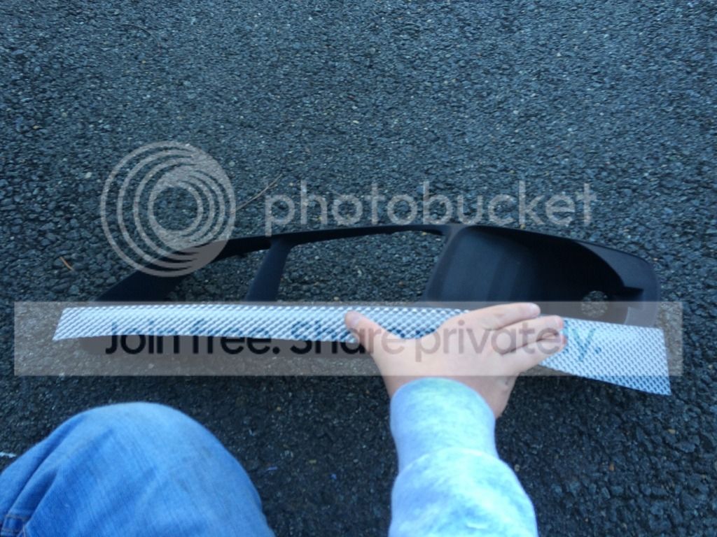

No problem! jist a reminder, it's quite difficult to cut exactly right. Use a dremel and cut the top curve first, then cut the bottom. Ill post pics so you see what I'm talking about.

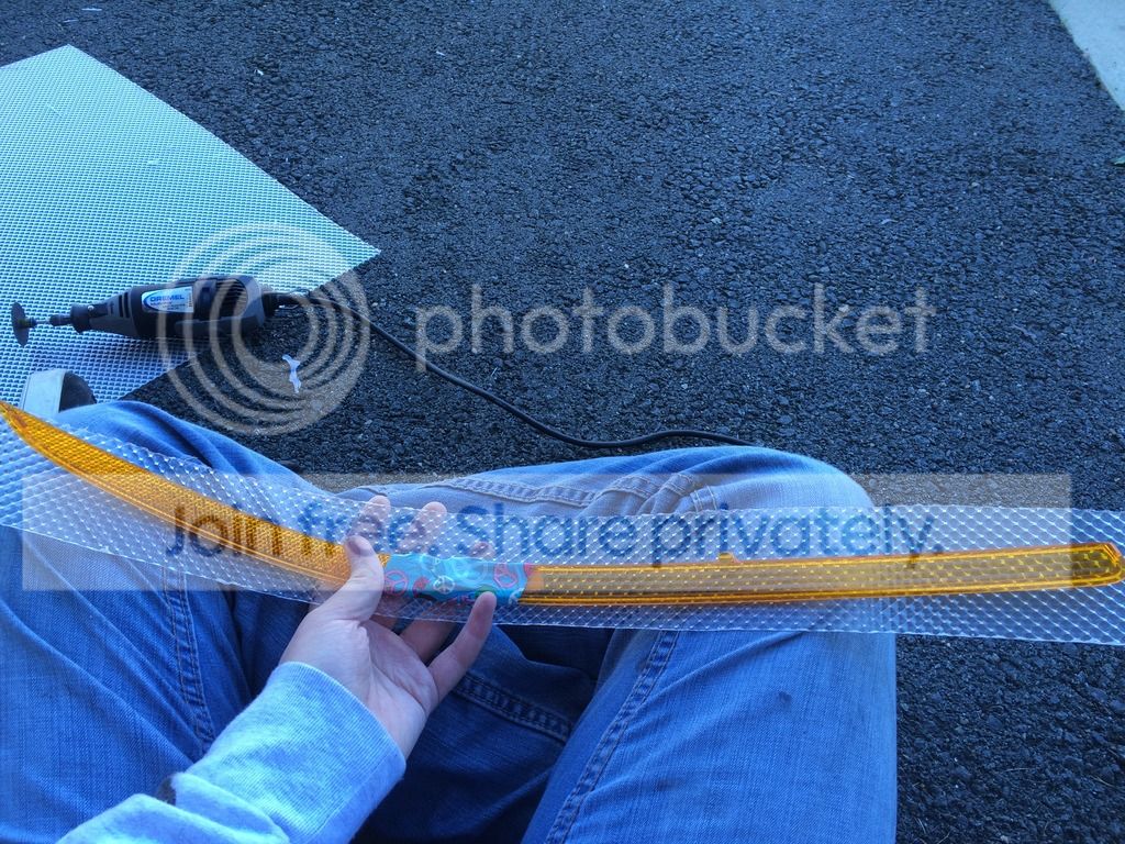

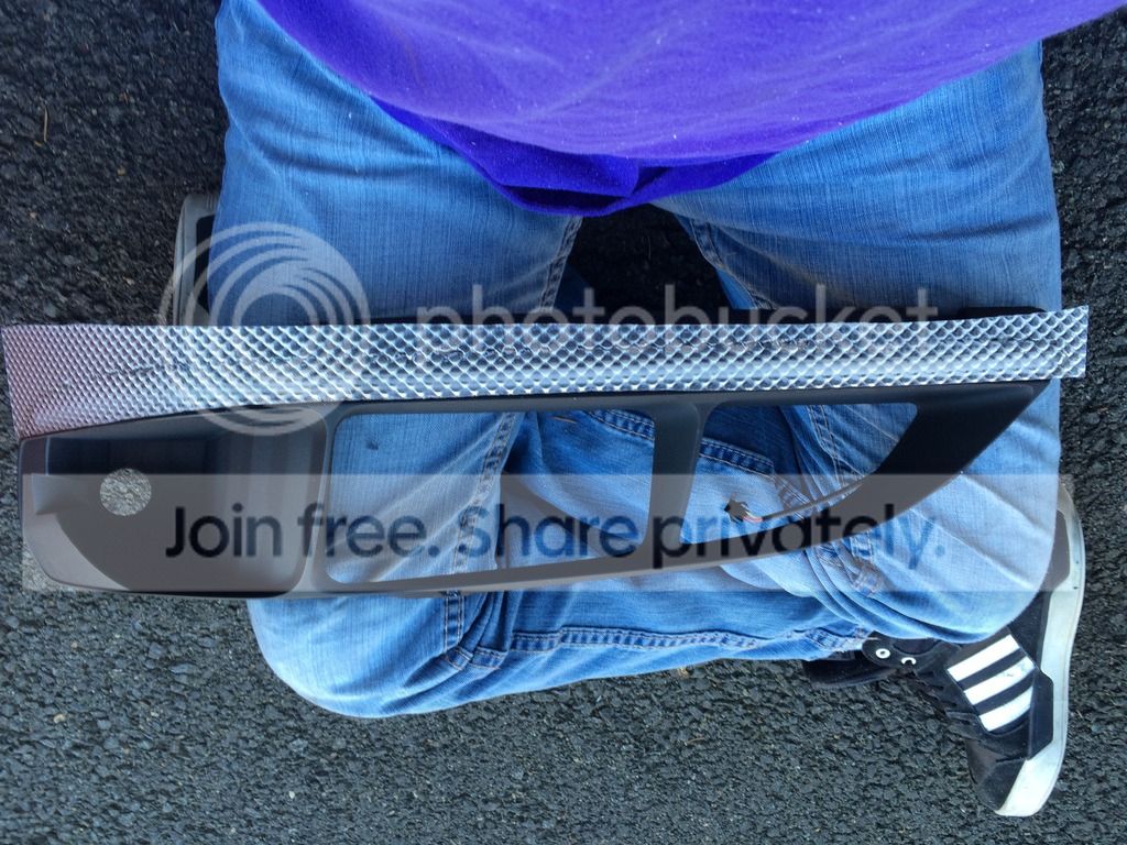

Sorry it took me so long, I had forgotten :shakehead:
First, you cut a piece of the diffuser. Second, you trace the OEM reflectors.
Next, cut and sand the top curve till it's perfect. Then epoxy it on.
Finally, with a dremel and a steady hand, go along the untrimmed edges and cut them as close as possible to the OEM plastic. Then sand until it is perfect.
Hope this helps :)
Hope this helps :)
That is perfect! Thanks! Working on that next week!
