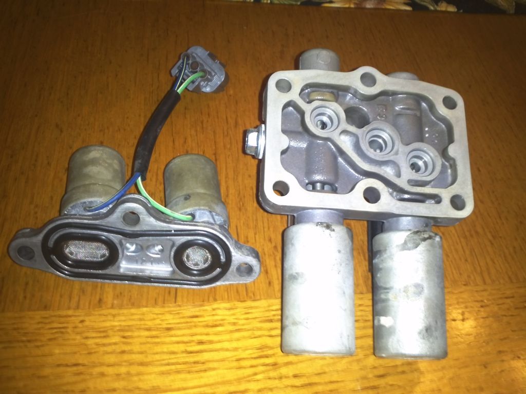

TCC Solenoid

I would personally recommend anyone to change their 2nd/3rd clutch pressure switches once a year along with their tranny drain and refill after seeing the great difference it made for me when changing them out. I had a slight hit when going into second when cold which fully went away and became buttery smooth.
What are the part numbers for these clutch pressure switches for my 2000 Accord SE 4 cylinder?
Update, so far so good, drove it for about a week to work. No CELs and transmission shifting okay. I feel a slight hesitation when I slow down- but not to a complete stop - and then speed up again, the moment that I need to speed up, sometimes I get a brief hesitation. This was happening before but with the recent transmission problems I guess I am paying more attention to everything. Wonder if these pressure switches could fix this hesitation problem?
index.php
12 28600-P6H-003 SWITCH ASSY., OIL PRESSURE (TEXAS INSTRUMENTS) 1
13 28600-P7Z-003 SWITCH ASSY., OIL PRESSURE (TEXAS INSTRUMENTS) 1
16 90471-PW7-A00 GASKET (10MM) 2
