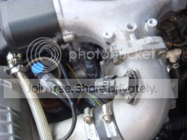

if its not reading, i may be able to help you out because i had to do it..
my car/dash is '99, my ecu is '03
you have to drill the sensor into the flow port of the engine (thermostat housing) and then run a single wire off that sensor to a wire on the bulk connectors on the left strut tower.. when i get home i can try to take pictures and show you
MikeyMike
Aug 13, 2006
3,222
914 Yonkers NY
the yellow/green wire by itself in the middle of the picture..
closer shot of where its drilled into
splice into the green/yellow wire on the firewall side of the top connector
