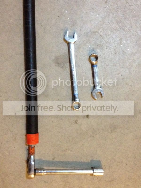

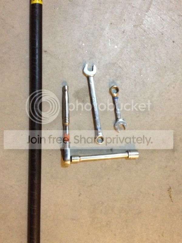

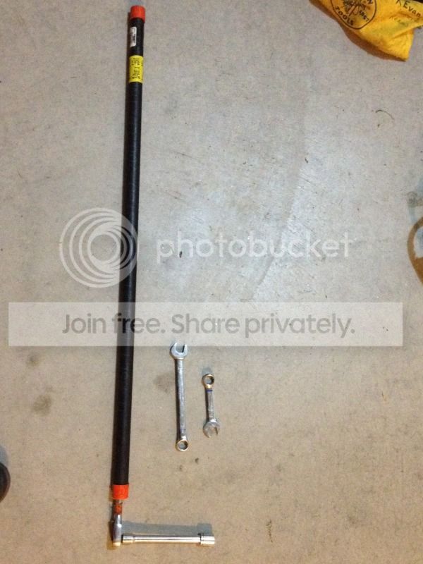

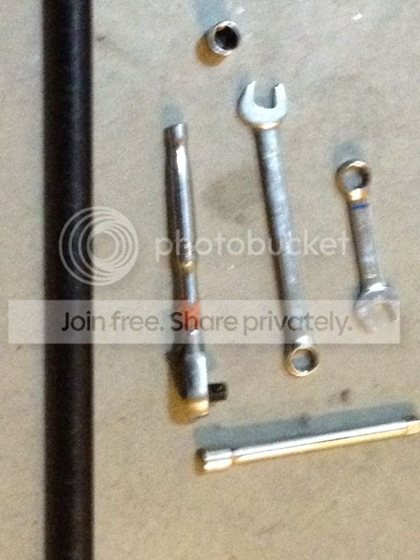

I used a ratchet with a 14 mm (or is it 15?) socket with a fairly long extension, the ratchet then sits out away from the rotor and you can put a steel pipe over the ratchet wrench. Voila!
If you line up your wrench that is holding the bolt still with the frame somewhere so it gets 'stuck' when rotating, you can then use both hands to hold the ratchet and push the pipe at the same time (I used a 3 foot pipe it provides plenty of leverage).
If you like, I can certainly take a picture of what I'm talking about.
ejreams
Feb 12, 2009
1,494
Fort Collins, CO
Okay so you need a 15(or 14mm socket preferably a extended one)
-3 foot steel pipe (home depo for like 8 bucks then return it.. lol)
-15/14mm wrenches (one short one)
-Good old PB blaster (wait 35-45 minutes and use it 2 times if its really bad but I doubt you'll need to)
-And don't forget the ratchet wrench + extension lol
There
