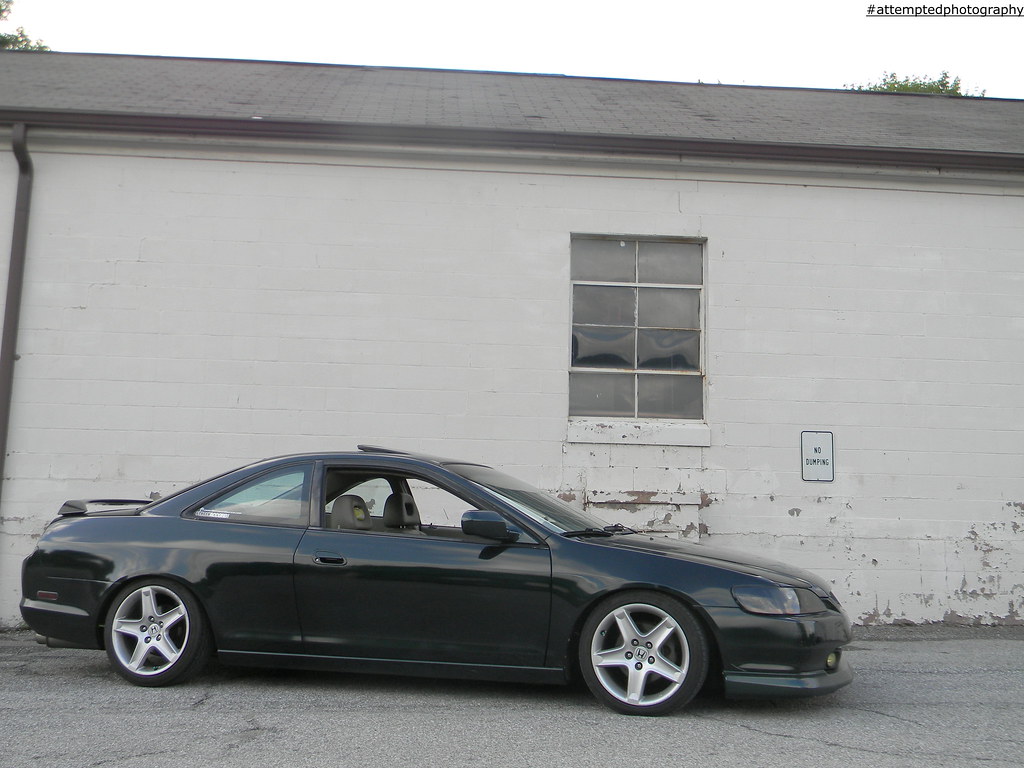

    Anybody have any experience or pics of 225/45/17 on their ride?
  5. puzzlemaster94

  6. guytv
    guytv Well-Known Member
    Posts:
    152
    Likes Received:
    Joined:
    Jul 28, 2013
    Location:
    hill
    That looks nice:waytogo:. Do you 17.x8.5 +30 think will look nice on those? Do you think the extra .5 will be too wide for it?

  8. puzzlemaster94
    puzzlemaster94 6GA Connoisseur
    Age:
    25
    Posts:
    1,482
    Likes Received:
    Joined:
    Jun 6, 2012
    Location:
    Louisville Area
    I'm running 18x9.5 all around now. You can easily fit an 8.5 with that offset.

    Fosho. Hopefully the combo of 17x8.5 +30 with 215/45/17 fit well. I don't really want it to show any poke. I just want the wheels and the tires to be snugged together for a normal look. That's why I keep thinking about 225/45/17 but at the same time I don't want the tires to look too wide for the car. Thanks for the help:waytogo:
    Also, is that 18x9.5 with 215/45?

  10. puzzlemaster94
    Age:
    25
    Posts:
    1,482
    Likes Received:
    Joined:
    Jun 6, 2012
    Location:
    Louisville Area
    I'm on 215/40s
