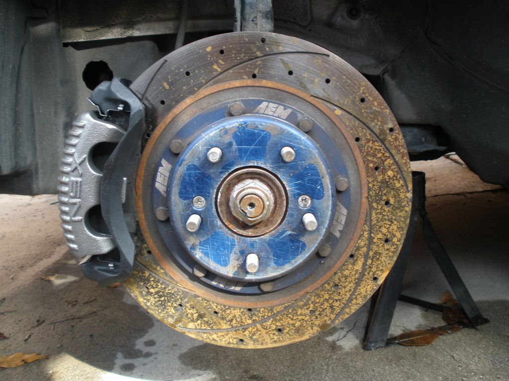

Your going to need 17" wheels and up to clear an AEM BBK. I can't say if the stopping power is the same with stock calipers since I upgraded to NSX calipers. They retailed at about 500-600 when they were new. They are now discontinued but I believe that they still produce replacement discs but I'm not 100% sure.
Here's mine, don't mind the rust lol.

Since the caliper is moved outward the brake torque is increased. This will reduce the pedal effort to get the same braking force as the stock system on the front axle. This change also would alter the front to rear brake balance (front lockup even earlier than stock), and add rotating, unsprung mass. Your braking performance for the first stop is limited by the grip from your tires, not the brakes themselves. It's already easy to press hard enough on the pedal to lock the wheels. The only advantage the larger rotors really offer is fade resistance for continuous hard braking. Unless you're going to track the car you wouldn't even appreciate this one advantage.
not sure if i agree with this.. the braking surface is still the same as tht is determined by the caliper pistons.. how can brake torque increase with just the relocation of the caliper?
