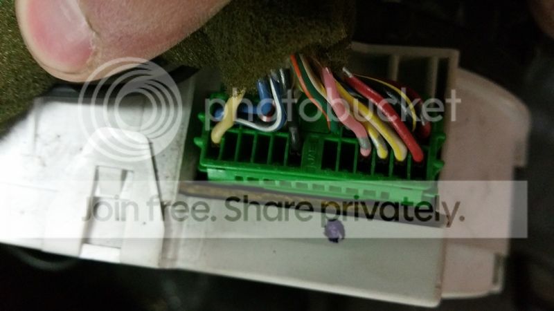

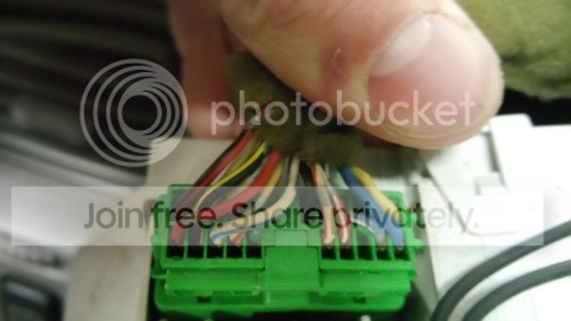

mikewohlwend
Apr 15, 2015
69
Ohio
Power without the fuse in was 11V, same as with it in. I also measured it at the harness connectors.
From L-R - 0, 0, 2, 11, 11
From L-R - 5.5, 0, 0, 0, 0.75, 5, 5, 0
Does this help figure things out any?
