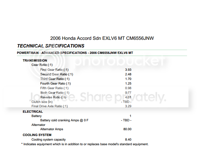

Thanks for the example Kevin. Except mine is from a 2006 Accord 6MT, so I would need to find the gear ratios for that. Guessing they haven't changed much, but I want to make sure I do this right.
@Clean, 5th in the 8GA example is less than 1. So 4th is the gear that is a little over. If I'm understanding this correctly.

Chris looks like the only difference is the final drive is 3.29 rather than 3.55
