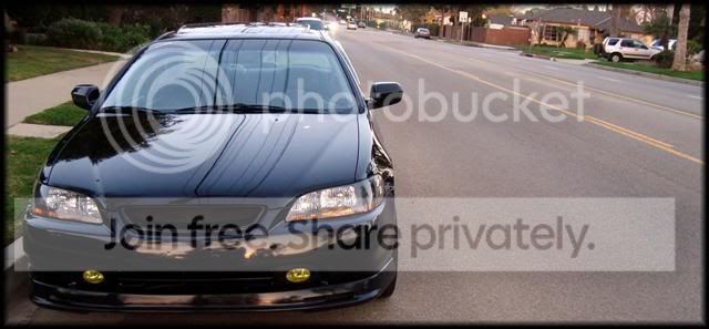

Just finished installing the fogs and detailing.
Took pics in honor of RussianRed and juicebox00, I couldn't of done it w/o you guys.:omgbd:
how do i give rep points? hahahaha
they look sick man, and i guess i don't need to help you in person anymore...lol. and you give rep points by clicking on that weight thing in the upper right hand corner of every post
