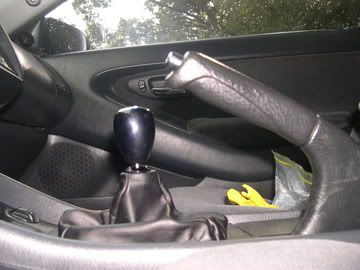

I know you're not looking at the PSPEC, but here's mine after the job.
I like being one of the fourty people I know of that have this :afro:

My neutral position is at a reference point of 6".
N to 3rd comes approx. to 7.5"
N to 4th comes approx. to 4.5"
So that's an inch and a half shift from N to 3rd or 4th, and three inches between the two.
So if the stock throw is 2.5 inches, and mine is 1.5 inches. If my math is correct, that's a near 60% difference in throw:D
