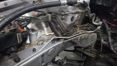

Small update over this long weekend. Cut the 4cyl psgr side bracket off the 6GA. Removed the spot welds holding the piece of CLS wheel housing. Wasn't too bad using a spot weld cutter and a chisel. Also relocated the ABS unit and brake hardlines. Need to clean off some of the sealant on the 6GA. Plan to put the motor back in to verify the position of the mount before re-welding.
With the relocated ABS unit, I can cut the hole needed for the CAI. Which is conveniently stamped on the body.

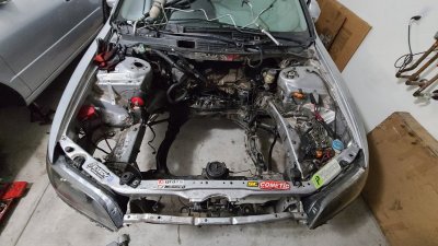

Spent lot of time yesterday and today with ecu wiring. what a mess that is... :whymewhyme: Also re-set the motor on 3 mounts and laid some quick welds to transferred bracket. set the rl manifold on top and test fit the rear header. rear bracket touches the manifold just a tad. plan to notch the bracket.
Anyways here's a pic.. yes, I wrote oil out... lol

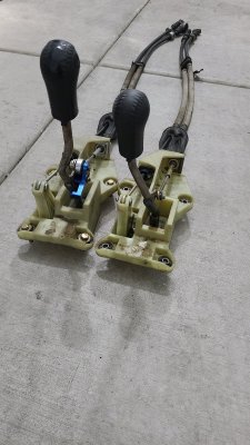

Gee whiz info, the cls 6mt has slightly different shift cables and shifter vs 6GA 5MT. Obviously that needs to change too.
older NSX shift knob matches the CLS. That's what I used to replace worn out cls knob
Oh dang, I didn't even see that you'd posted before. Here's a pic that shows different "shift levers" (Honda's name for it) The factory shift cable stay on the transmission has 3 locations (or 'slots') that the shift cables can go into, yet only two are used. Dependent upon which of these is installed in the transmission determines which of the 'slots' the shift cables go into.
The two on the left are overseas variants.
Middle right is all of the J-series except for the 2003 CL-S 6MT.
Far right is 2003 CL-S 6MT.
The select lever (not pictured) comes from the side to side motion in the shifter, and these shift levers are from the forwards and backwards motion of the shifters. Is the difference between the Accord shifter vs the CL-S shifter such that a forward motion of one pulls the cable, whereas the forward motion of the other shifter pushes the cable and vice versa? (sorry if my wording is confusing here)
When I'm building transmissions and if I don't get this correct, it can result in someone having a backwards shift pattern
4-5-6-R
1-2-3
